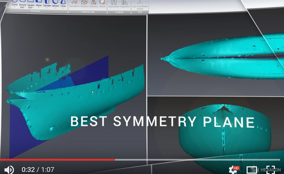

hello, I meant like this.
I found this article about an algorithm that does this https://hal.inria.fr/inria-00331758
thank you
fabio
thank you
fabio
- Immagine.jpg (94.63 KiB) Viewed 4354 times
Re: Verification symmetry Hull
Oh ok I understand now.
You'll just have to find (or motivate) someone to implement this algorithm then ;)
