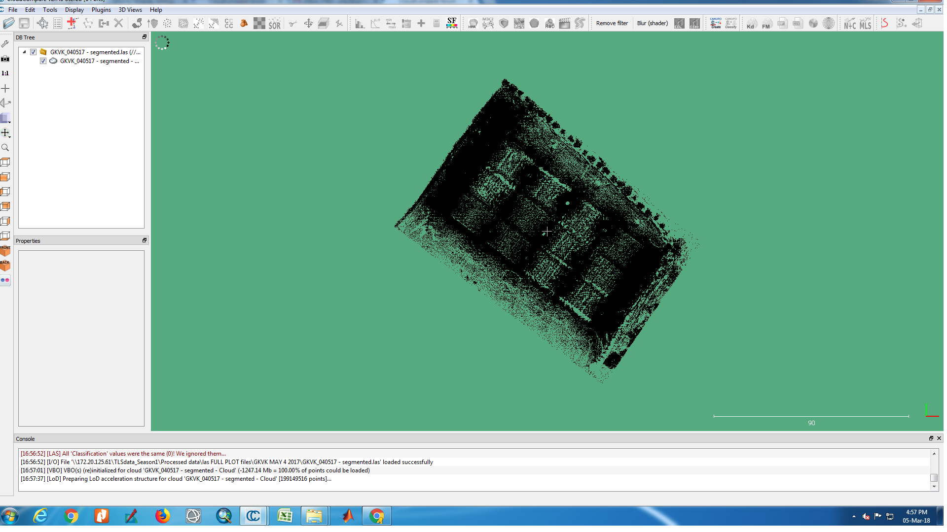

My data taken using Faro scanner S when its loaded in CC is looking black and white only. I tried to change the display settings also . But it didnt work for me.I am attaching the file here
Re: Regarding the display mode of .las data
Can you show the cloud properties at least? Does the cloud has an intensity scalar field? Or normals?
