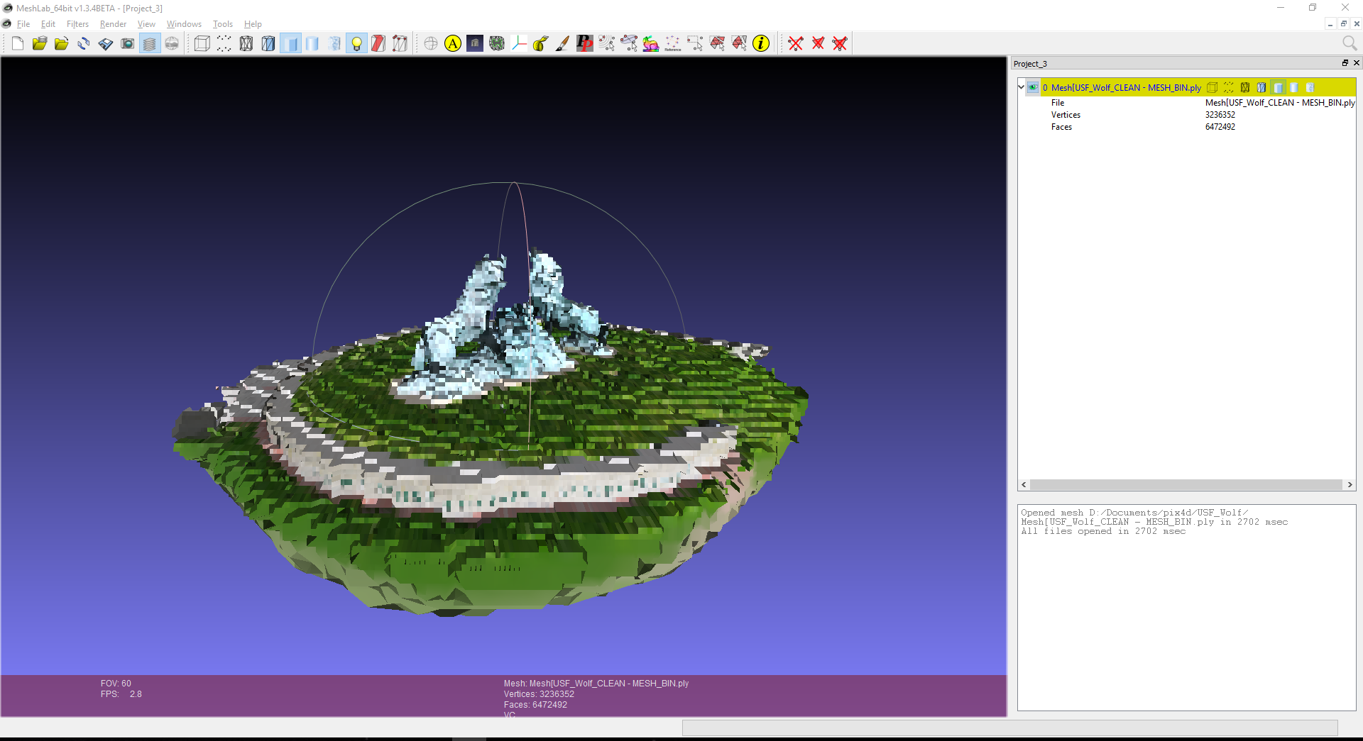

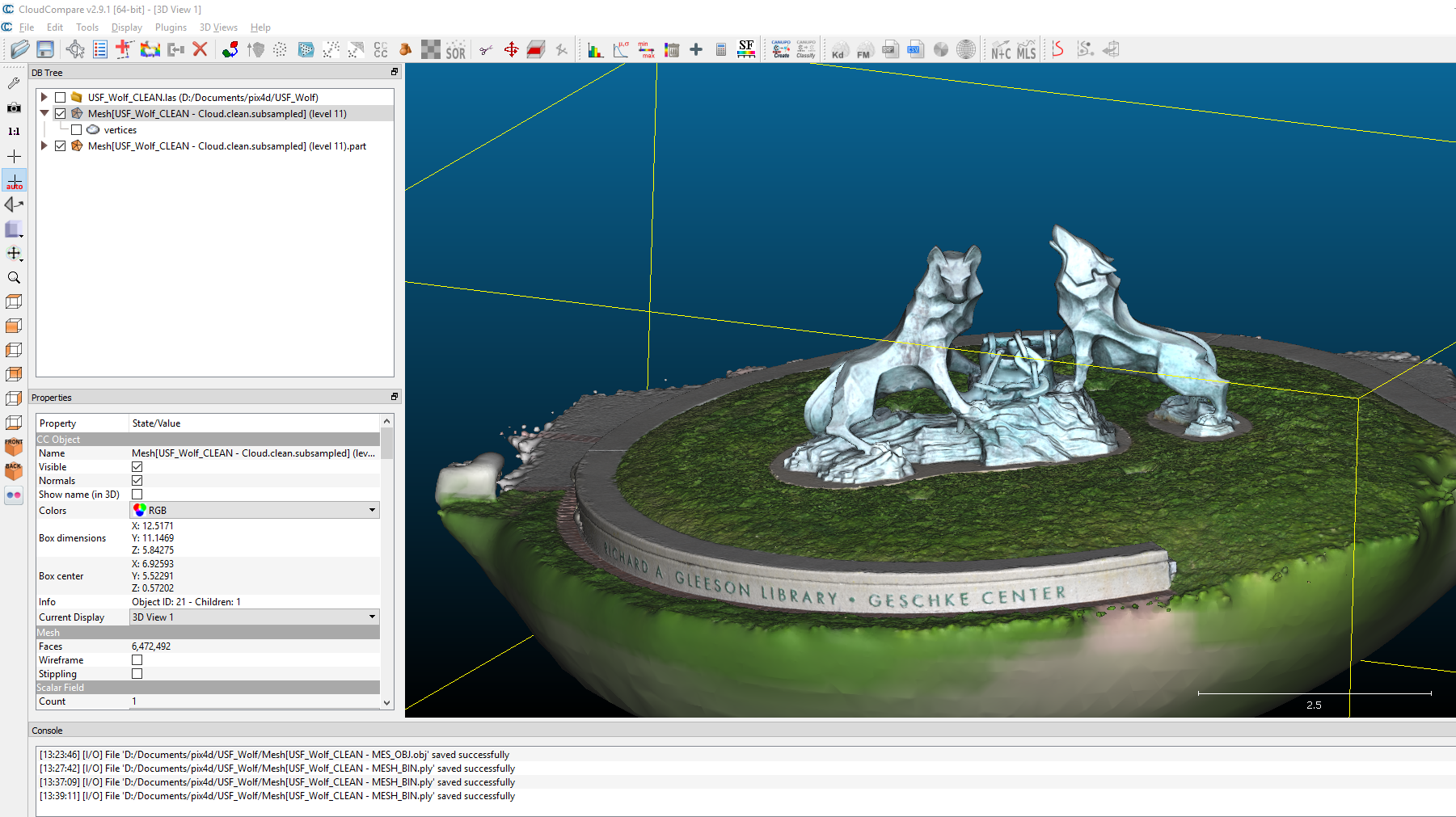

I am new to CC and could use some help. I created a mesh from a point cloud and attempted to export to Meshlab. The mesh looks great in CloudCompare but when I export it looks like it is seriously decimated or something. Very Low Res. I will include images to illustrate. To export, I just click the layer and save as a binary PLY. this happens no matter the format. ASCII or OBJ.

Ah, ah, it looks funny at least ("Minecraft" style). It as is the coordinates were read by Meshlab as integers instead of floats... Can you share the file with me maybe?
