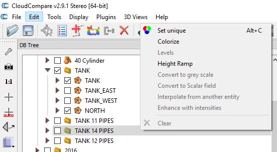

Post by Steve L~ »
Here's a screenshot showing the invisible Edit menu, but visible sub menu (if you guess where the menu is)

Re: Mouse pointer not visible, can't access menus
Can you maybe try with the latest 2.10.alpha version? (online). It's compiled with Visual 2017 instead of 2013... Even though I'm afraid it's probably another bug between Qt and the graphic card driver...
Oh, indeed, it IS a Qt bug: https://bugreports.qt.io/browse/QTBUG-62004
I'll simply update Qt asap. Wait a little bit before downloading the 2.10.alpha version...
EDIT: ok, it's done
