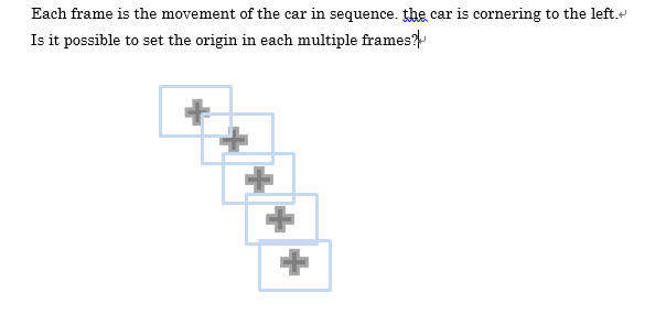

I am working on differentiating stereo camera and SLAM which embedded on car to analyze the same scene.
First of all,
1. Is it possible to set origin in each multiple frames to see the movement of the car in sequence?
2. Is there any particular method or parameter to set the origin of the picture?
Btw, I'm using pcd files. I'm sorry if my points is not that clear but you can try to understand my points from below:
Thank you and i am looking forward hearing from you!

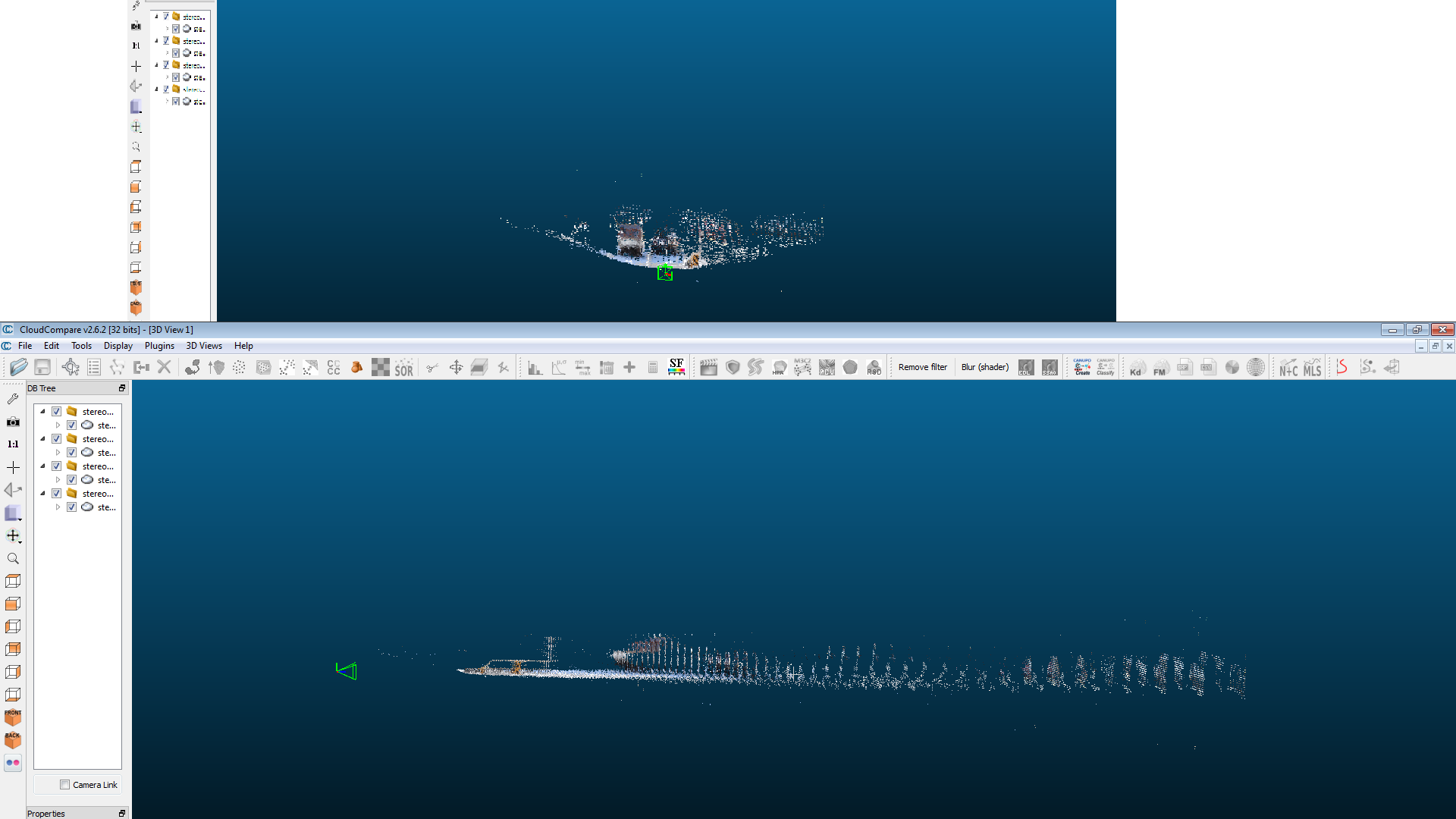

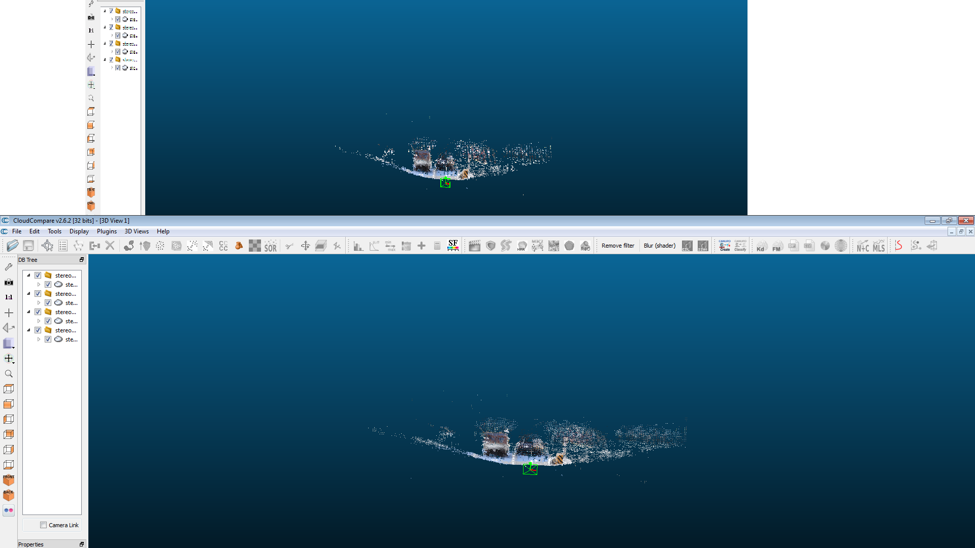

I used the sensor that you were saying.
sensor 2.png (164 KiB) Viewed 4839 times
sensor 1.png (146.26 KiB) Viewed 4839 times
As you can see in the picture above. I loaded 4 images or I called it as a frame of pictures where the scene was captured by stereo camera which embedded on the car.
The sensor that I created show the view from the stereo camera of the car which is correct.
But, I have 4 frames or images which consists of 4 different angles or view since the car is moving and change direction. Therefore, my point is, is it possible to have 4 sensors to each frames or images to see the car is actually changing the direction or what not?
Thanks!
