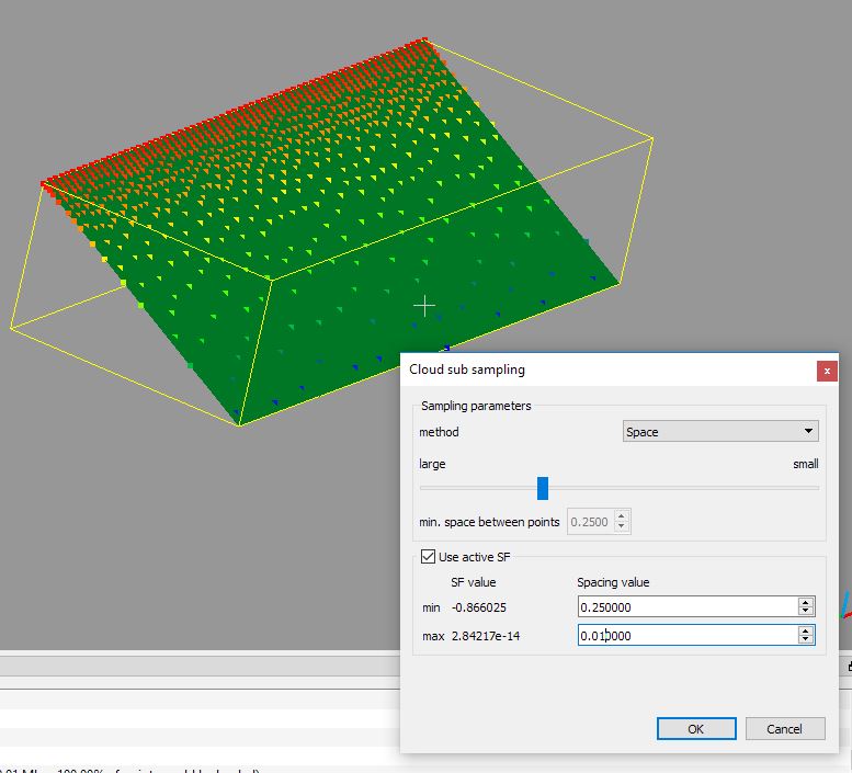

Re: CloudCompare freeze when Subsample by active coordinate Scalar Field
Well, I'm not sure what you are trying to achieve with a mesh (in "Cloud"Compare ;). However I assumed you were trying to resample the vertices?
Here's what I got (after setting the Z coordinate as scalar field):
It works fine on my side. And it works also if I do this on a sampled version of the mesh (plane).
