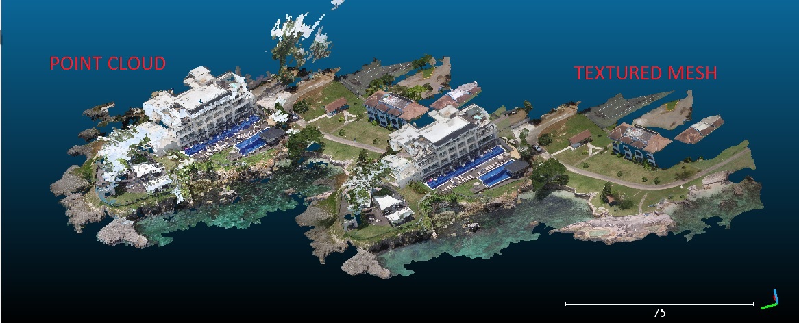

I also have a .obj mesh created in Pix4d that is importing into CloudCompare out of position, but near the proper georeferenced position.
My .las point cloud is properly located, and both are shown in the attached photo. It prompts me for global shifts when I am importing the point cloud, but not when I'm importing the mesh - does this influence?
I understand that Pix4d doesn't georeference its meshes, and also that is generates some kind of offset file to translate the mesh to the output coordinate system.
How do you apply such a translation to the mesh so that is can display in its correct location? Or what else can be done to achieve this?
Thanks!

- 3d Mesh Import Problem.jpg (187.67 KiB) Viewed 3798 times
Re: OPEN MESHES WITH SAME COORDINATESSYSTEM
What does the offset file looks like?
Because if it's a simple translation, you can either apply it directly as the 'Global shift' (the one you apply when you load the cloud file) or otherwise with the 'Edit > Apply Transformation' tool (but you'll have to take the already applied global shift into account).

Just FYI, Pix4D is exporting the offset file in ASCI formatted XYZ translation. Hitting Edit->Apply Transformation and providing these 3 values in Euler Angles Tab (XYZ translation) gives a georeferenced mesh in CloudCompare.
Thanks!
