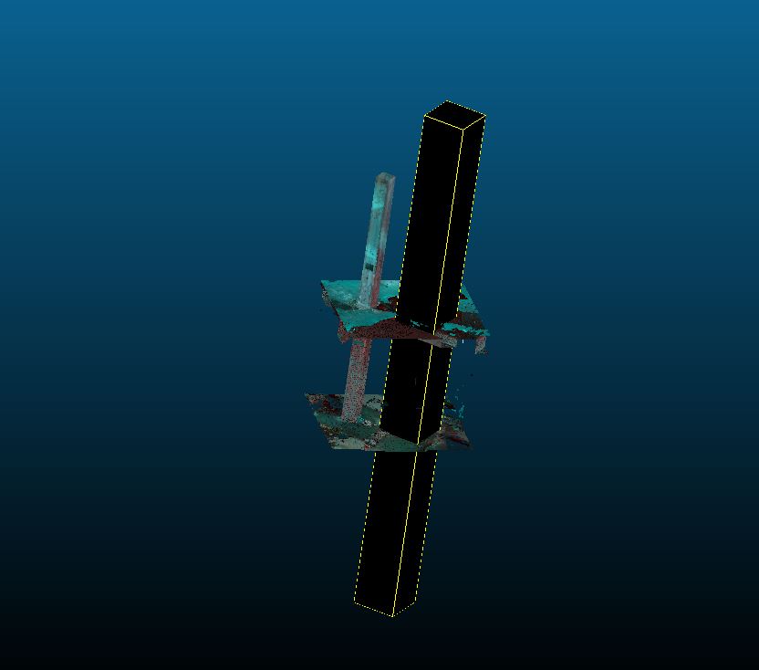

Hi! i'm new user in CC.
i have problem - when upload pts and fbx files I get different scales.
in the source files the scale is the same...
Re: Problems with comparison between CAD Modell and Point cloud
How did you asserted this?
The only solution would be that there's a scaling value somewhere in the FBX file that is not taken into account by CC (however we use the official FBX SDK to load the FBX files...).
If you can give me the right scale and the files I could search where the missing information is (you can send mail to cloudcompare [at] danielgm.net).

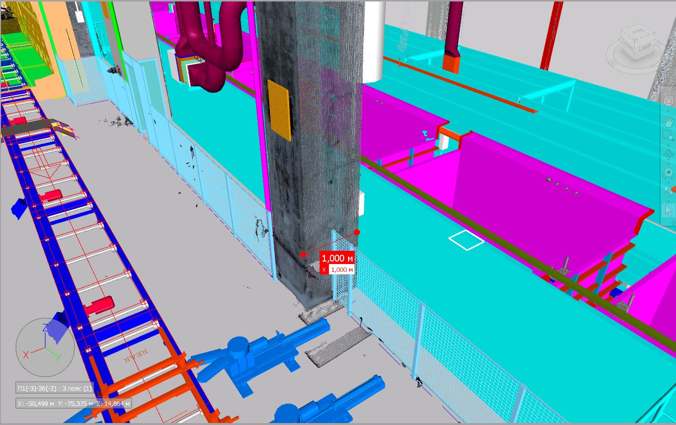

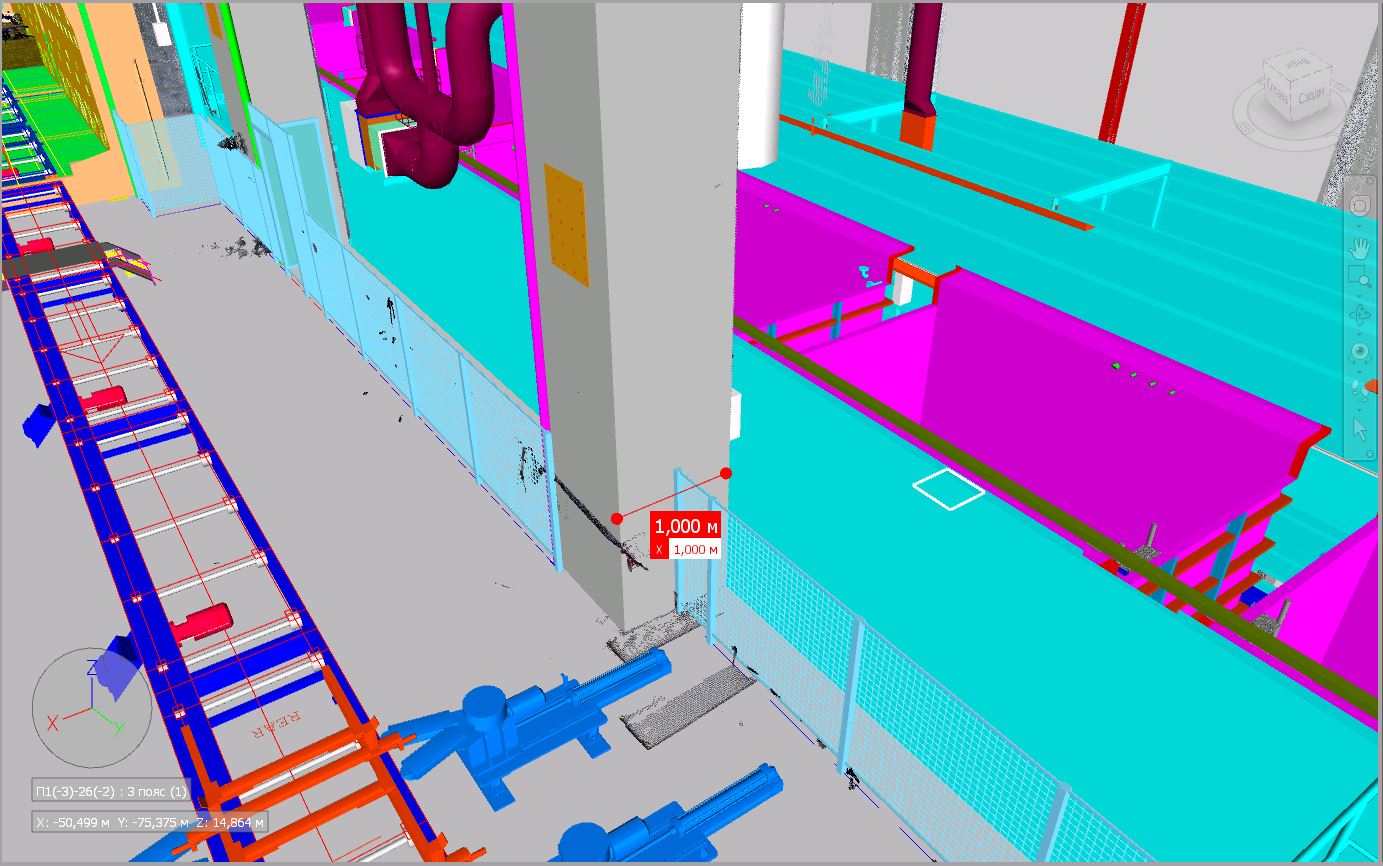

Joined: Wed Oct 04, 2017 8:00 am
Post by Leonid »
This model in Navisworks (Autodesk). According to this model, a building was constructed. We scanned the building and compared with the model in Navisworks. all converges. I get the file FBX through export from Navisworks. I think the problem is in the export.
