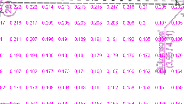

I am wondering if there is labell scalar field in grid form and automatically.
At the moment I am doing the following.
1- C2C compare (see C2C)
2- Export x,y,z,scalar field to Autocad
3. make grid (e.g., 1*1 m)
4. do labelling manually (see image_scalarfield) (I have switched off point cloud for better visuallisation)
How can I do it i better way in C2C

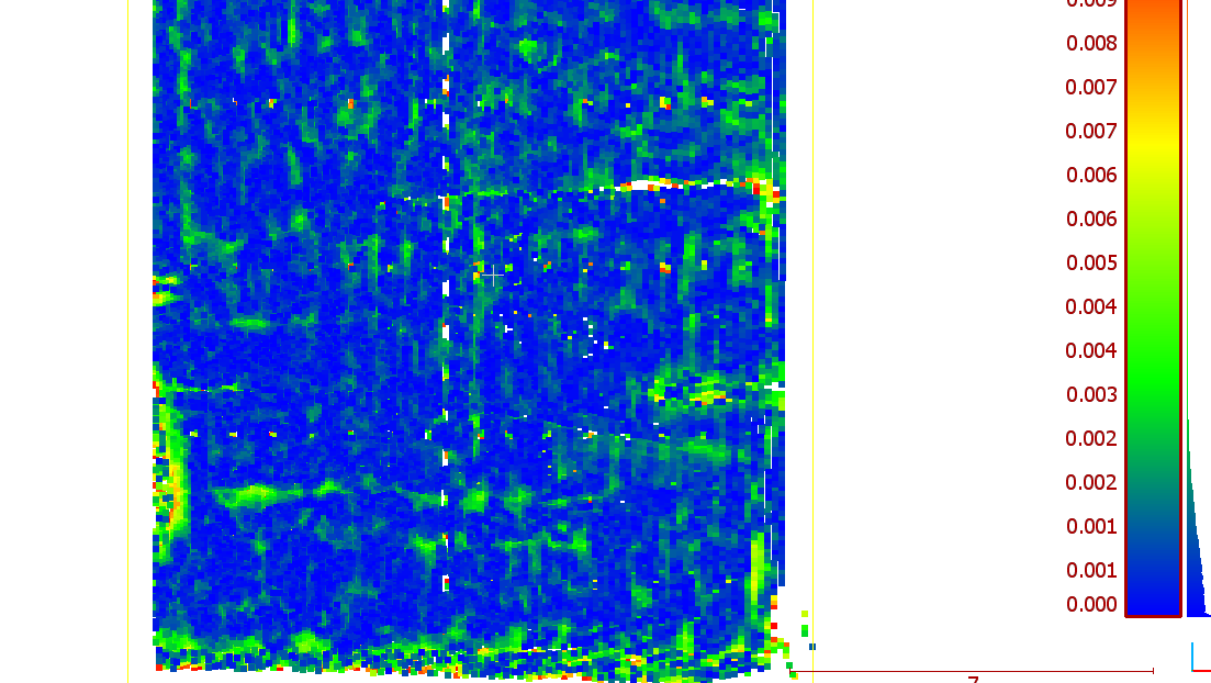

Re: labell scalar field in grid form and automatically
I'm not sure if it helps, but you can use the Rasterize tool to generate the grid AND export the result as a 'ASCII matrix' file with all the values corresponding to your labels (see http://www.cloudcompare.org/doc/wiki/in ... CII_matrix).
However I'm not sure if it will help you create the labels in Autocad automatically ;)
