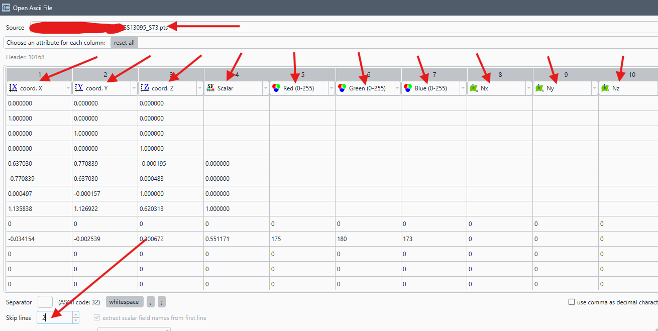

the header will not be read as sensor data at all, for now, in CC, using the ASCII I/O filter, as EVERY row will be interpreted as points and/or normals or scalar fields, or RGB channels. This can be set at import time.
Screenshot 2026-06-05 143534.png (57.59 KiB) Viewed 10396 times
please note the trick. .ptx edited to .pts
opened with ASCII filter
set up things in the import wizard form (note the arrows)

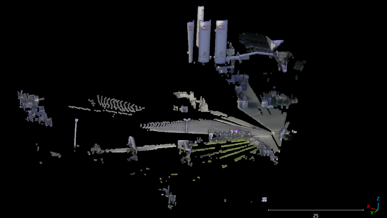

result:
Screenshot 2026-06-05 144142.png (266.89 KiB) Viewed 10396 times
normals and RGB are valid
