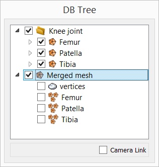

Merging meshes
When merging meshes, the original meshes are not modified/deleted. CC will create a new composite mesh structure. Sub-meshes are also created for each input mesh so that the original structure is preserved (useful when saving the result as an OBJ file).
Merging meshes (input: 'Knee joint' group - output: 'Merged mesh' entity)
Notes:
  • all triangles are copied but not actually merged topologically speaking (i.e. they won't share the same vertices). Refer to the qCork plugin (Boolean Operations on Mesh) to do this
