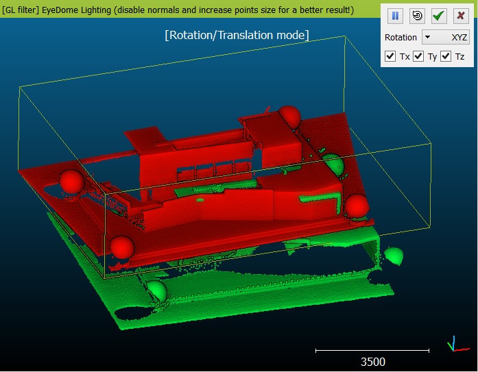

This tool allows the user to interactively move the selected entities relatively to the other ones (or equivalently to the default coordinates system).
"Rotation/Translation" tool in action

The standard mouse interactions with the 3D view are used to modify the selected entities position (instead of the current camera):
  • left click: rotate
  • right click: translate

At any time, the user can 'pause' the transformation mode (click on the 'pause' button or hit the space bar) in order to modify the camera position/orientation, and then restart the transformation process by 'un-pausing' it (new click on the 'pause' button or new hit on the space bar).

Optionally, constraints can be added to the applied transformation:
  • rotation can be constrained to a single axis (X, Y or Z). Use the drop-down menu to select the current dimension.
  • translation ca be constrained to zero, one or two dimensions only (among X, Y and Z). Just uncheck the dimensions that should be ignored.
When done, use the validation icon to apply the transformation, or the cancel button to revert it.
