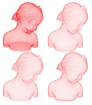

qHPR stands for "Hidden Point Removal" and is an implementation of the method proposed by S. Katz et al. in their article titled 'Direct Visibility of Point Sets'.
The algorithm filters out the points of a cloud that wouldn't be seen (by the current 3D camera) if the cloud was a closed surface. Therefore it tries to remove the points that should be hidden in the current viewport configuration.
