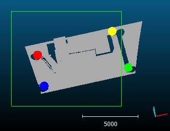

Equivalently the user can select multiple entities by holding the CTRL key and clicking on entities in the 3D views. Another option is to hold the ALT key and drawing a rectangle in a 3D view. This way, all the entities falling at least partly inside the rectangle will be selected:
Selection inside a rectangle (hold the ALT key while drawing the rectangle with the left mouse button pressed)

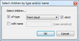

Since version 2.6.2, a new option of the context menu is available: 'Select children by type and/or name'.
This option lets the user select the children of the highlighted entity based on their type, or their name or both:
