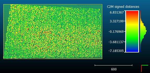

Fitted plane (+ distances between the original cloud and the fitted plane)

  • the fitted plane is added to the DB tree as a child of the cloud
  • the plane primitive is a kind of 'triangular mesh'. Therefore you can select both the cloud and the fitted plane and compute the distance between them (with 'Tools > Distances > Cloud/Mesh Dist.')
