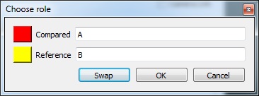

To launch this tool the user must select two clouds (and only two).
Then the user must choose which cloud will be the A cloud (equivalent to the 'Compared' cloud when computing distances at each ICP registration iteration - as this is where this concept is used) and which cloud is the B cloud (equivalent to the 'Reference' cloud).
