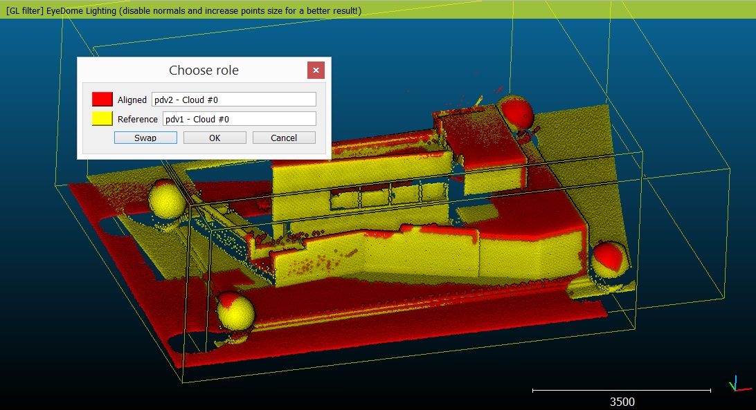

Role assignment
Then you'll have to designate (with the classical 'role' assignment dialog) which cloud will be the Reference (won't move) and which one will be the aligned cloud (the one actually moving at the end):

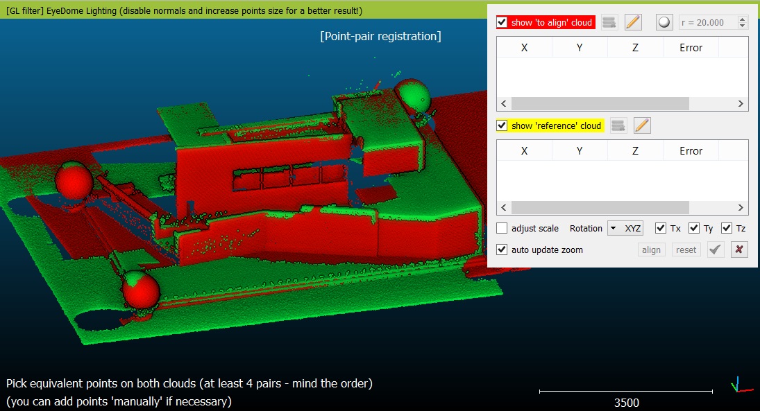

Once this is done, the two selected entities will be displayed in a dedicated 3D view, and a new dialog will appear in the upper-right corner.
'Align (point pairs picking)' tool - initialization state

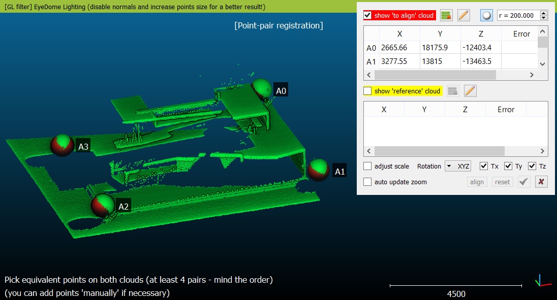

You are invited to select on both clouds the same set of remarkable points (mind the order). You can:
  • input (virtual) points with the 'pencil' icon (e.g. ground control points)
  • pick points directly on the clouds (3D view)

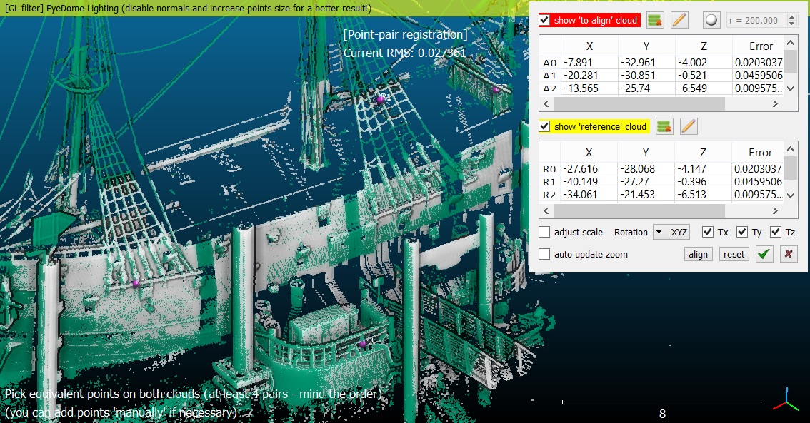

  • since version 2.6.1, you can optionally check the 'white sphere' icon (top-right corner) and set a search radius (roughly the radius of the registration spheres in your scans if you know it). Once activated, CC will try to detect a sphere in the cloud around each point you pick. If successful, it will use the sphere center as registration point. Note that the input radius is only indicative (it will be used to search points around the one you pick). CC will then automatically detect the best fit sphere radius (it is displayed in the Console, along with the best fit RMS). Spheres and simple 3D points can be mixed without any problem.
During this process, you can hide either the 'reference' or the 'aligned' cloud with the dedicated checkboxes. You can also freely rotate/translate the view point, enlarge points, zoom in or out, enable or disable OpenGL shaders, etc.
Each time you pick (or manually input) a point, a new entry appears in the corresponding table (either Aligned or Reference), as well as a marker in the 3D view (aligned markers begin with 'A', and reference markers begin with ... 'R').

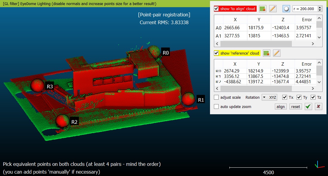

As soon as you have selected at least 3 or more pairs (you must have picked exactly the same number of points in each cloud) CC will display the resulting RMS and you can preview the result with the 'align' button. You'll also see the error contribution for each pair next to each point in the table (so as to remove and pick again the worst pairs for instance). You can add new points to both sets anytime (even after pressing the 'align' button) in order to add more constraints and get a more reliable result. And as suggested before, you can also remove points with the dedicated icons above each tables or with the 'X' icon next to each point.

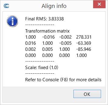

You can validate or cancel the current registration process with the green 'V' and red 'X' icons. On validation, CC will display a report (the same set of information is displayed in the Console (with increased digit accuracy).
Registration report
