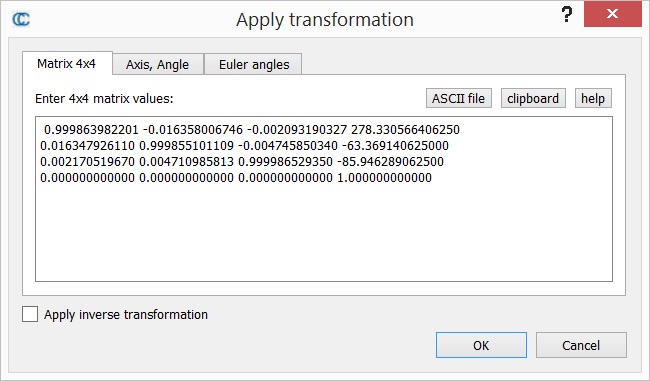

Transformation matrix
A rigid transformation matrix is a composition of a rotation (a 3x3 matrix) and a translation (a 3D vector). For convenience, it can be written as a 4x4 matrix (the rotation matrix corresponds to the upper part of the 3 first columns, the translation vector corresponds to the upper part of the 4th column, and the bottom line is always filled with 3 'zeros' and a 'one').
In he first tab ("Matrix 4x4") the user can input the matrix values directly; or load them from a text file (each row of the matrix on a single line, i.e. 4 values separated by a space character); or eventually paste it from the clipboard. For instance, most of the registration tools in CloudCompare will output the final transformation as a 4x4 matrix in the Console. The user can copy it (with CTRL+C on Windows) and paste it here so as to apply the same transformation to another entity.
