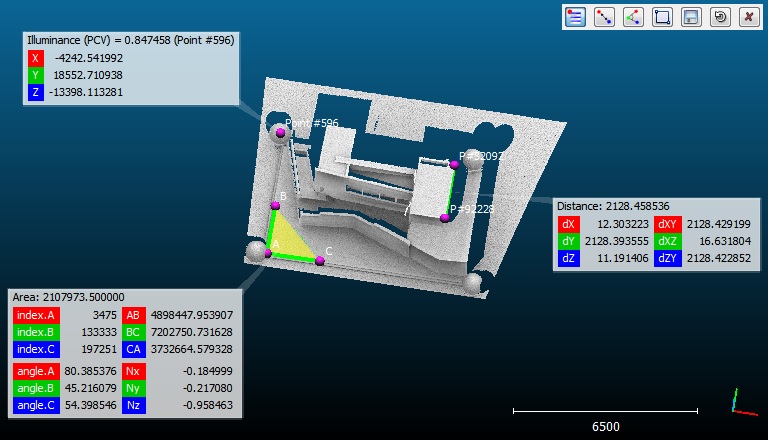

A toolbar will appear in the top-right corner of the 3D view. One of the following actions can be chosen:
  • spawn a specific label (, , or )
  • save the last spawned label ()
  • cancel the current picking process ()
  • leave this tool ()

1 point label
With the first icon , the user can pick any point and make a standard label appear.
This label will contain all the information available about the point:
  • associated scalar value (if a scalar field is active)
  • point index in the cloud
  • local coordinates
  • global coordinates (if any)
  • normals
  • RGB colors
Notes: an alternative way to create a single point label (outside of this tool) is to pick a point while pressing the SHIFT key.

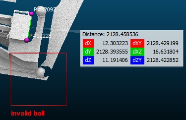

2 points label
With the second icon , the user can pick two points and make a 'distance' label appear.
This label will mainly display the distance between the two picked points (as title).
Additionally, the following values are displayed:
  • dX: algebraic distance along the X dimension
  • dY: algebraic distance along the Y dimension
  • dZ: algebraic distance along the Z dimension
  • dXY: distance in the XY plane
  • dXZ: distance in the XZ plane
  • dZY: distance in the ZY plane
3 points label
With the third icon , the user can pick three points and make an 'area' label appear.
This label will display the area of the triangle formed by the three picked points.
  • the indexes of the 3 points
  • the length of the 3 edges
  • the 3 angles
  • the vector normal to this triangle/plane
