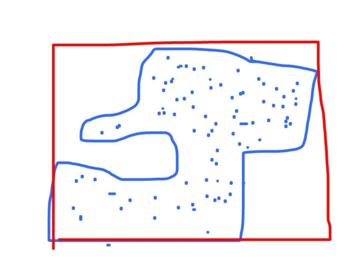

Most of the time, but not all the cases, optimum volume and area is when % of matching cells is close to % of shape area to area of containing rectangular (min x min y, max x max y)
and it is tricky
You can use try and error or visual inspection
Usually, you start with samll grid and increase till you get constant volume

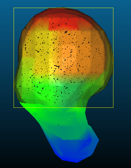

2.5d volume has limitations
Please check the attached example where 2.5d volume fails because 2 z levels in the same pointscloud
real volume=2.964 cubic units

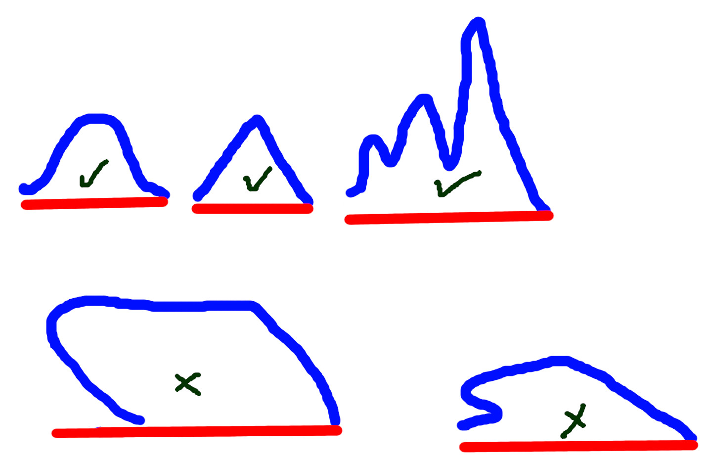

Re: About Volume calculation Results
Posted: Tue Jul 09, 2024 5:25 am
by DA523
2.5d volume between red and blue pointsclouds
x means 2.5d volume incorrect
