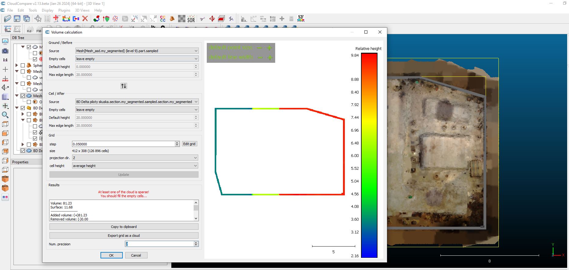

Ah, sorry I missed the part about the 'walls' ... so you would need to have a mesh that only delineates the top of the walls (section). Then sample points on this mesh (you would only have points at the very top, and only where the points will be).
Then you also have to mesh the point cloud (ground) so as to fill the holes. This can be done with PoissonReconstruction. But this may be even simpler to create 3 planes that represent the 3 flat horizontal surfaces. Then once again, sample points on these 3 planes.
Eventually, you can 'compare' the 2 clouds (the top section of the walls, and the ground (planes) with the 2.5D Volume calculation. It will give you the volume between the 2.
I couldn't make a video because tinkering with the OBJ mesh to extract only the top of the wall was hard (and not easy with CC). A very approximate result gives me something around 81.2 m^3 (assuming the cloud units were meters).

Si I really computed the volume of the colored parts indeed (so the 6 straight sections, with a constant thickness, and considering only the 'height' above the ground).
From what I understand, you only want to know a part of this volume, which extents are a little bit tricky to define ;). Not sure how I or CloudCompare can help you further...
