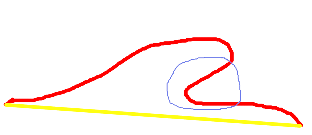

First 2.5D volume calculation tool does not work on multiple layers pointscloud

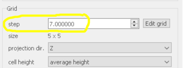

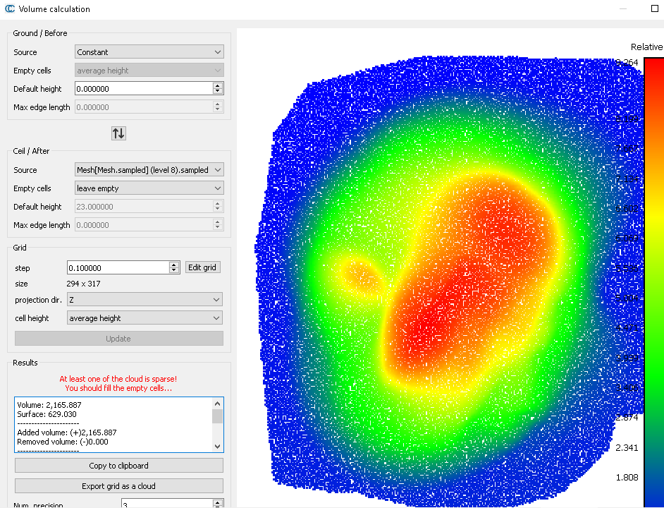

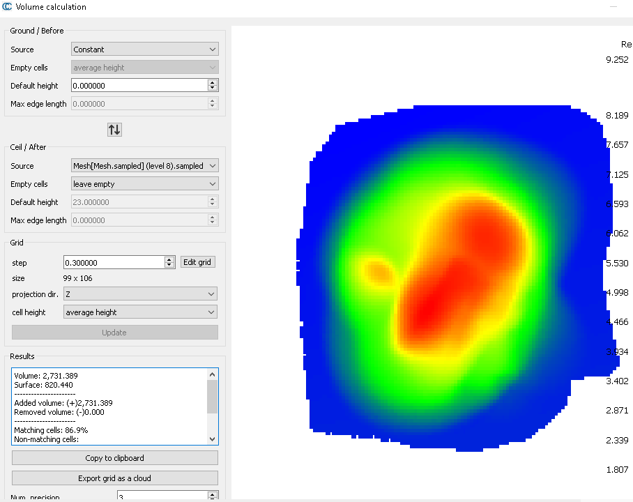

If you use underestimated (GRID STEPS) you get empty cells hence less volume
If you use overestimated (GRID STEPS), you get large cells hence a bigger volume (relatively depends on the percent of the projected area to its perimeter)
Usually, good practice on mesh (using sample points )gives real volume + 0.01%

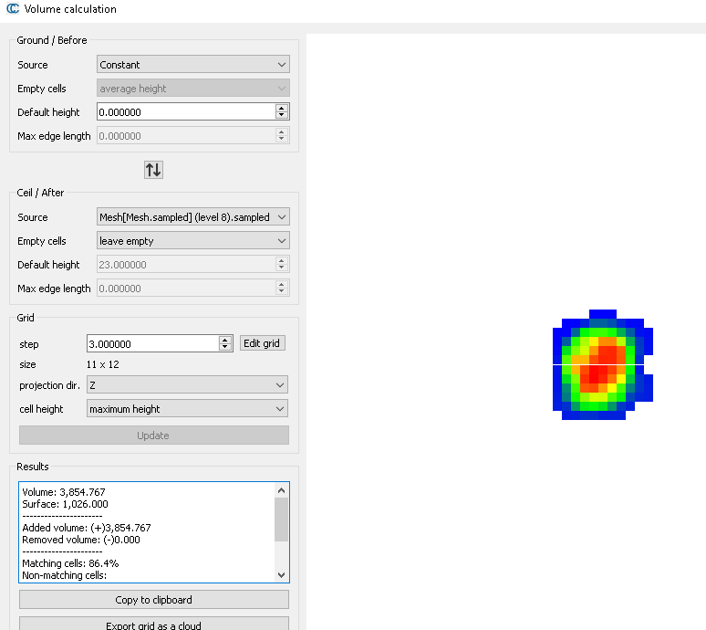

You can do trials on this attached mesh against a constant 0 plane by changing (GRID STEPS)

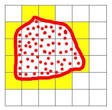

The yellow area around the perimeter shows extra volume (not true)If you use overestimated (GRID STEPS)
