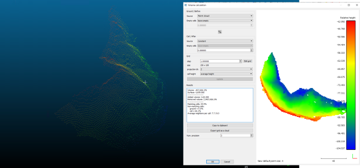

Hello all,
I'm new to CloudCompare and I would like to understand the Compute 2.5D volume tool using as source "constant" and a point cloud. I have a point cloud of a slope that I would like to know the volume. When I compute the volume of this point cloud with the "constant" I have an "added volume" but I don't understand to what is this constant based to calculate this volume and to what this "added volume" corresponds. Can someone help me understand what is this volume ?
Thank you very much in advance!
Re: Compute 2.5D volume - understanding
Posted: Sat Mar 05, 2022 11:11 am
by daniel
The 2.5D Compute the 'vertical' distances between the points and either another cloud, or a constant plane (Z = constant = 0 in your case). Then it sums the individual volume contribution of each point. As you have set the constant plane as 'after / ceil', the distances are inverted and are probably negative.
And it's 'added volume' if the volume is positive (i.e. the points are above the constant plane) or 'removed' if it's negative.
