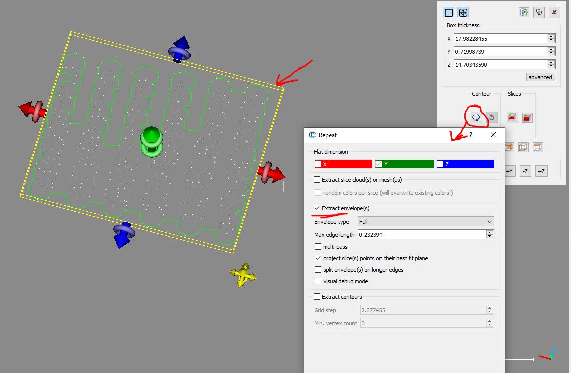

It should not matter if they are not on the same Z level, I think the confusion is terminology, in the cross section tool under extract contours, the thing you are asking for is called "Extract envelope" rather than extract contours.

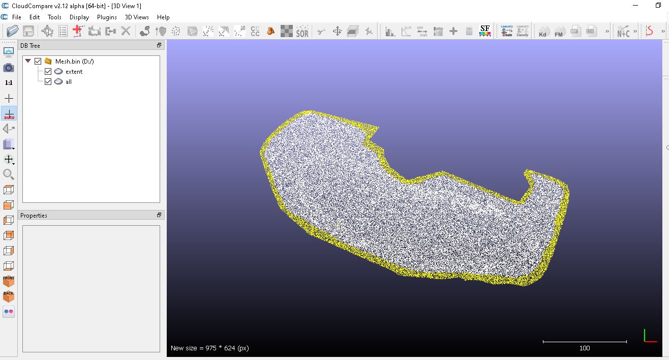

Also if you want the points near the envelope, you can use the Cloud to Primitive distance tool to evaluate each point to the polyline that represents the envelope
You can then filter the cloud based on that distance.

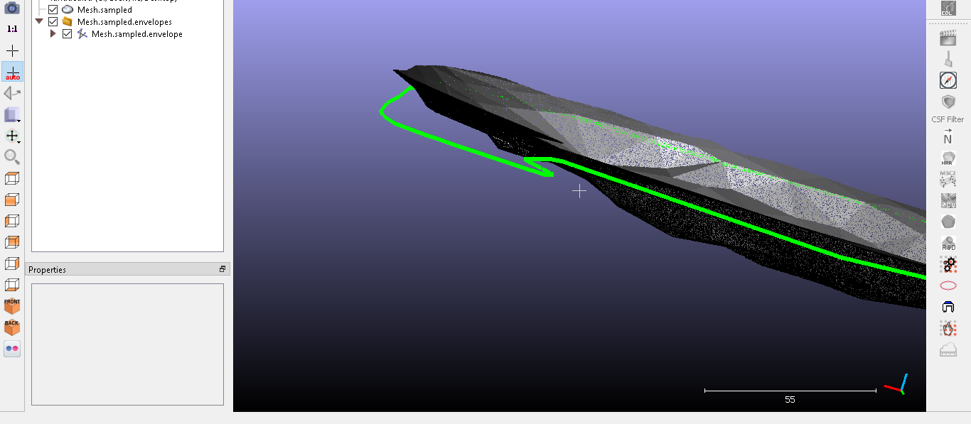

This helps a little but Z values of polyline does not match Z of perimeter of mesh?
XY are OK

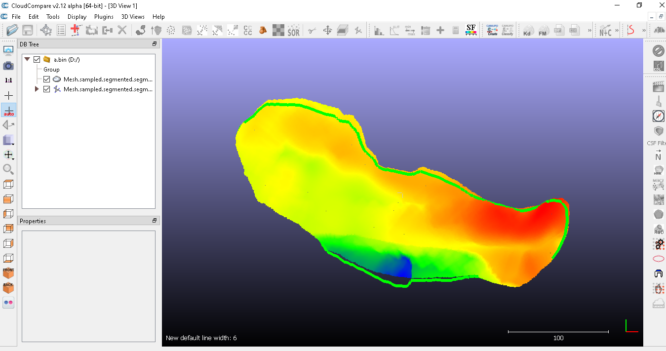

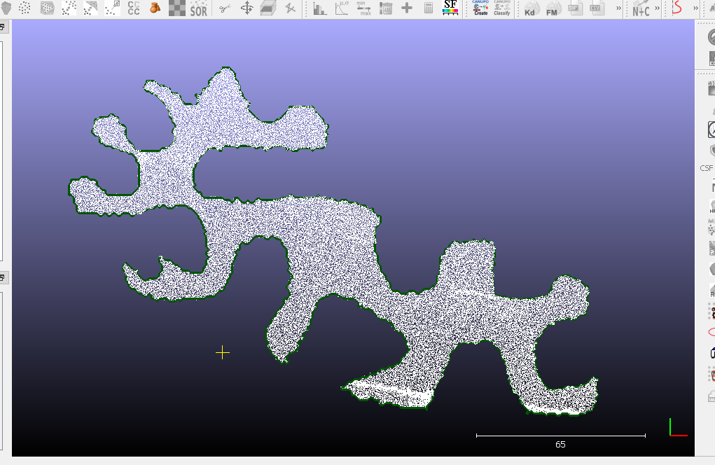

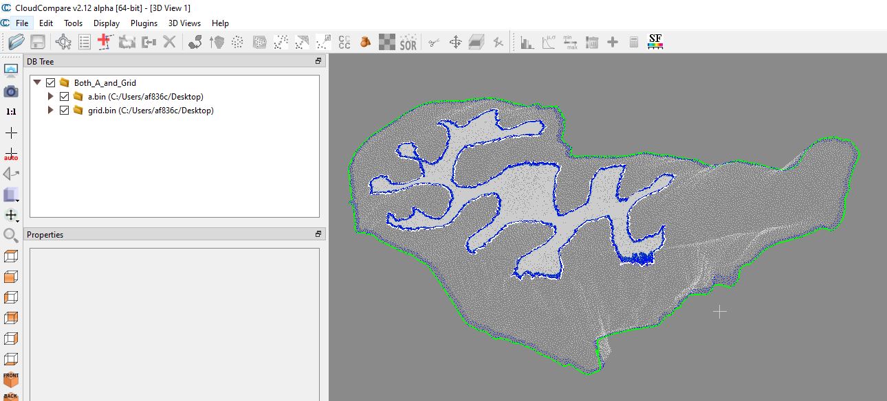

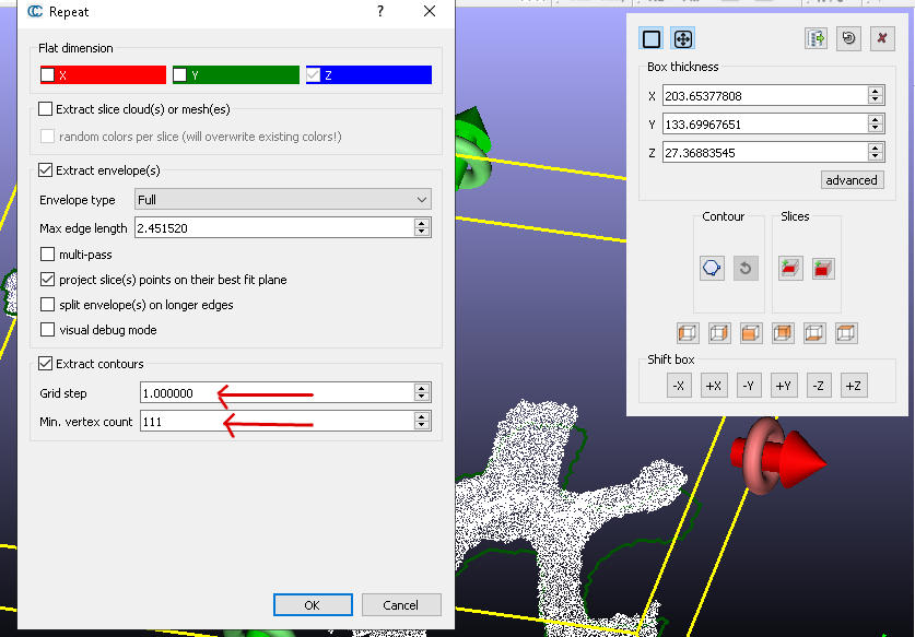

However, I found that polyline contour sometimes is not accurate in xy plane especially if there is big variation in mesh Z
see in image below
But playing with grid step & min. vertex count makes result polyline accurate in xy plane

by WargodHernandez
I had good success following what I told you, zeroing out the Z value getting the contours then restoring the Z values. only extra step I didn't mention was to interpolate the original clouds SF values to the vertices of the extracted contours and restore the Z SF to the vertices as well to get the contours to follow up to the original locations.
