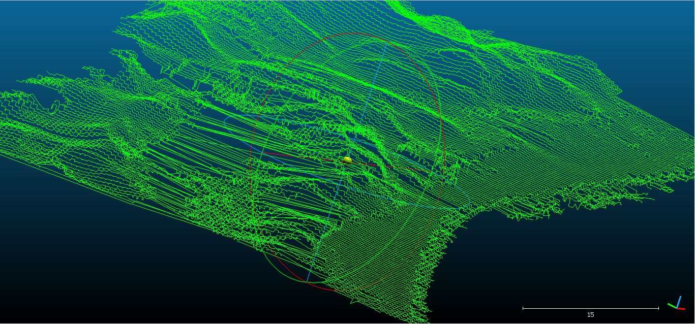

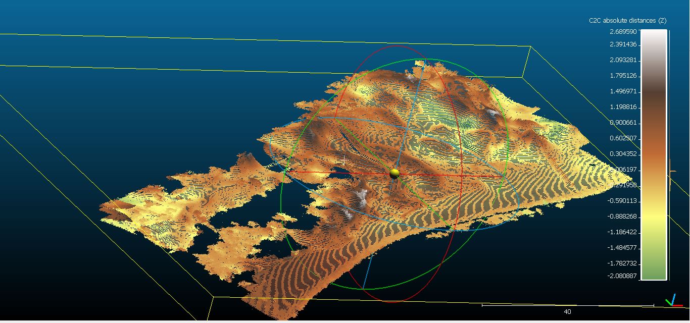

Okay, here's a snapshot of what I'm working with. I want to measure shoreline recession, and I have an older data set (reference) and then a newer one to compare against the reference. It is difficult to determine the extent of the shoreline by examining the point cloud. I tried to use a series of polylines to mark the shoreline, but I wasn't able to create anything accurate enough to be meaningful. Maybe I'll just create them in QGIS and import them?
I've included screenshots of the compared point cloud and the profiles I extracted from it. I was thinking I might be able to use the profiles from each cloud, but I haven't got that figured out. Nevermind those holes...the ground was snowy in places.

CloudCompare is not particularly strong with polylines. Therefore if QGIS can already do what you are looking for, I believe it's the best path forward? (especially since I heard the latest version should now support 3D point clouds?)
