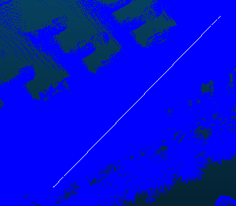

But I need to add at the end
before it can be displayed.
But there seems to be a problem with the code to set the color.
If I write directly
there is an error
I wrote it as
Or
Neither can display the color.

polyline->setColor(col);- Attachments
- DeepinScreenshot_select-area_20210531153432.png (12.74 KiB) Viewed 11215 times
Re: How does the “Trace a polyline by point picking” tool implement line marking in the code?
Ah ok, it could be also 'polyline->setColor(ccColor::Rgb(0, 0, 255));' I guess then.
Have you called showColor(true) afterwards?

Thank you very much.
Perfect solution to my problem
In fact, he's got the color, but he doesn't show it.
polyline->showColors(true);
That's why he shows the color by default.
