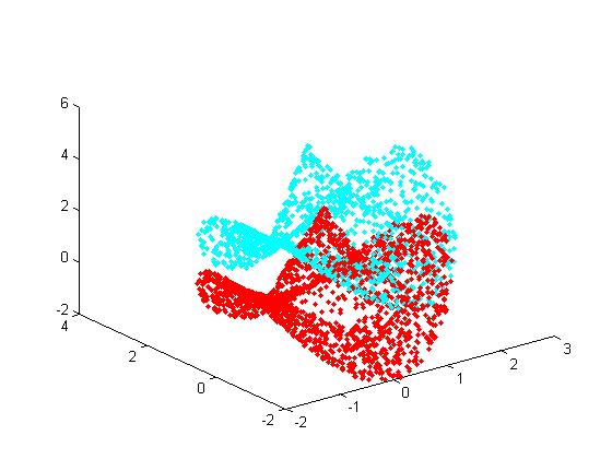

For the display axis, what I want is this XYZ axis in CloudCompare
Re: Display/View axis of CloudCompare
Ah! We only have the small trihedron in the bottom right part of the screen.
One option is to export the result of CloudCompare (the point cloud with distances) as an ASCII/text file and open it in Matlab or another equivalent tool.
