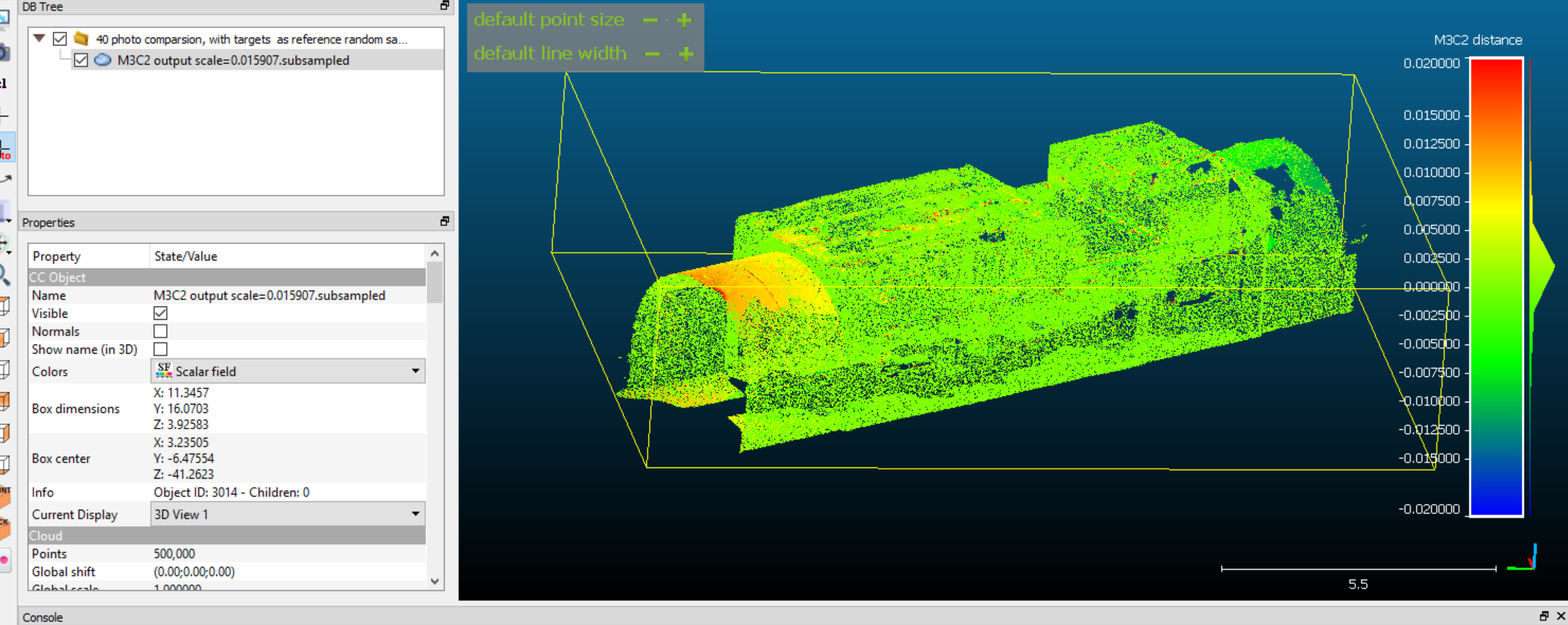

I am new to CC, I am comparing the laser scanning point cloud and photogrammetric point cloud, and i computed the M3C2 distance between two point cloud, and it show the mean and standard deviation after i plot the Guass distribution fitting, but i didn't find any other information such as rms, sigma.
Do i need to export it to excel and do it by myself? is there any other assessments recommend to do, i am also trying to export the m3c2 point cloud to compute the rms of distance uncertainty.
WeChat Screenshot_20180821225340.png (1.81 MiB) Viewed 5965 times
Re: sigma
If you really fit a Gaussian Distribution to the histogram, then you should also get the RMS in the Console (with the latest versions). And the 'sigma' is the standard deviation ;).
Otherwise you can indeed export all the points and their associated scalar fields (distance, confidence, etc.) by select the resulting cloud and saving it as an 'ASCII/text' file. You can even set the separator to 'comma' to get a nice CSV file that you can open in Excel (assuming there's not too many points ;).
