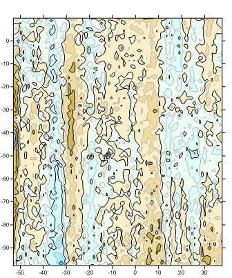

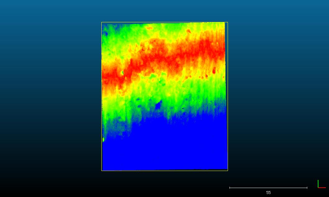

Data generated from the scanner as XYZ coordinates, but sometimes the scanner or the floor is not straight. How to do the correction of the data via CloudCompare?
Please find the attached file, Capture. PNG the correction of the values was done by other software. I don't want to have a slope.
Z correction
Z correction
- Capture.PNG (91.26 KiB) Viewed 7783 times
- s.jpg (41.49 KiB) Viewed 7783 times
