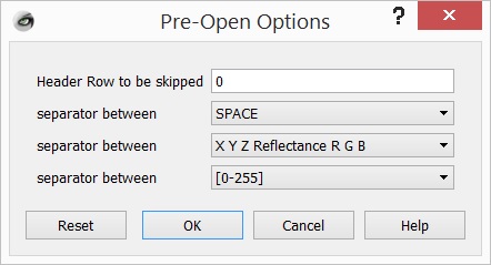

To open your file in Meshlab... you just need to use the 'txt' extension instead ;).
In this case you'll get the following dialog:
To load a PTS file, use the 'SPACE' separator, and the 'X Y Z Reflectance R G B' configuration (you might spot that they used 3 times the same field names - luckily their respective roles are pretty obvious each time ;).
