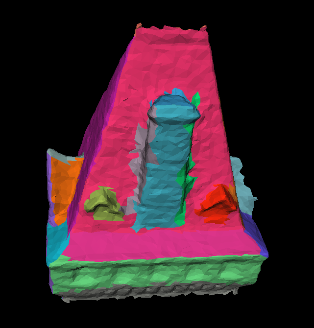

Why not render mesh with triangle color?

just like this

Well, it's actually possible to render a mesh like this in CC. But you need to define per-triangle materials. And the only formats that support this are OBJ and FBX.
Most of the other formats provide per-vertex colors...
