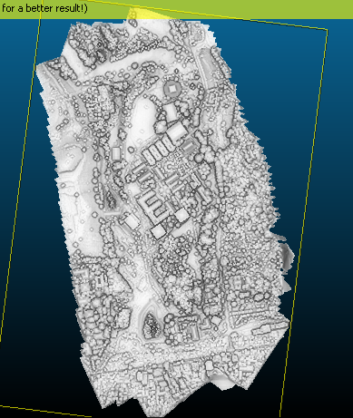

Posted: Mon Jun 20, 2016 10:19 pm
by pramudya
is this slope used in the PCA process ? i mean with this information, can canupo really differ between horizontal and tilted plane ( like football field vs road ) ? or is it hopeless to differ two objects that are both totally look 2d eventhough the orientation is different?
do you think it is possible to use canupo to classify this point cloud?
do you think it is possible to classify this point cloud?
