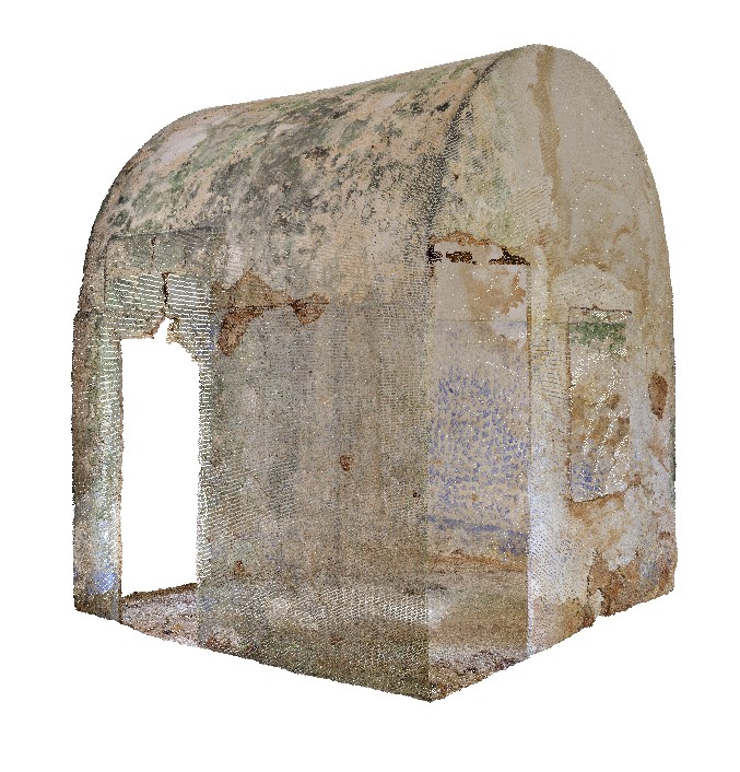

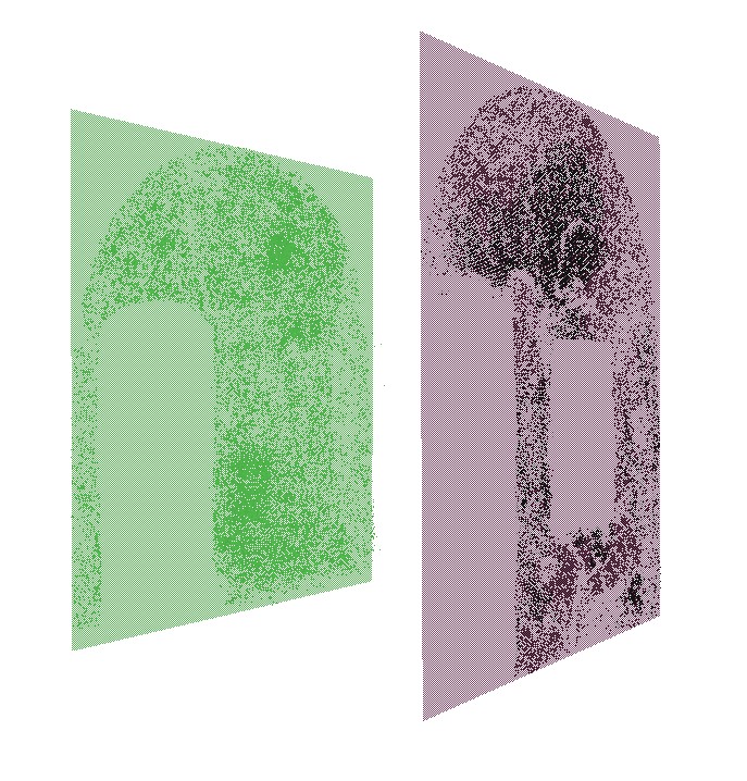

thank you for the reply. I tried to save the sub-clouds both in .ply and in .txt, but when I open these new files, I can no longer see the original RGB values associated with the points of the sub-clouds. Conversely, each point of the sub-cloud has a new RGB value (the same color for each point of the sub-cloud), resulting from the segmentation performed by the ransac (they are all green, or red, or pink,...). Is there a way to maintain their original RGB values instead of the new ones?
This is the original point cloud:
Immagine 2020-12-01 161451.jpg (148.64 KiB) Viewed 10634 times
and these are two sub-clouds segmented by ransac:
Immagine 2020-12-01 161822.jpg (166.8 KiB) Viewed 10634 times

Ok, I updated the command line mode so that no random colors are generated by default, and the user can use the "-OUT_RANDOM_COLOR" to enable random colors.
I've updated the code and the online 2.12.alpha version for Windows.
