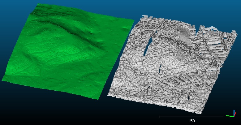

I also added an option to export the cloth mesh at the end of the process (I was curious ;):
- CSF_cloth.jpg (111.29 KiB) Viewed 354924 times
And regarding your last questions, I compared CC's with 2 other algorithms during my PhD and my Octree was faster. However it mainly depends on what you want to do. CC's octree is very good when applying a process on the whole cloud (which is exactly what we do when computing distances, etc.). But it's not that good for random queries done on a few points only.
