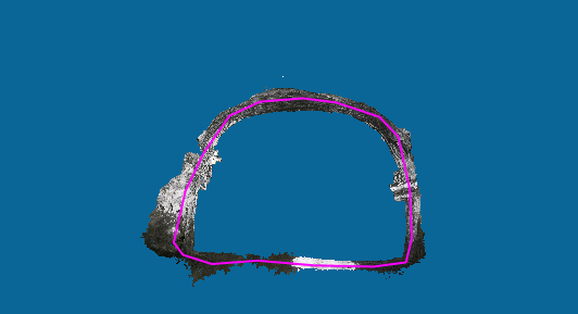

I am on Mac and using version 2.6.1, is the unfold button included in this version? I cannot see it in the extract section tools.
Also how would you unwrap a tunnel? would you put the polyline down the length of the tunnel or around it (See images)?
Also the Extract Sections tool does not work most times. When I right click to end the polyline it disappears.

Re: Texture of collapsed towers
Indeed, the unfold option is not available on Mac OS yet (but CloudCompare 2.7 version is about to be released and will be supported on all platforms... stay tuned).
To 'unwrap' the tunnel, you would have to use the second option (draw the polyline around it).
And the issue you report is probably a MacOS only issue. It should also be fixed with the 2.7 version (you can send a message to Andy Maloney to ask him about this - https://asmaloney.com/contact/. He may even be able to provide you with a beta version for you to test).

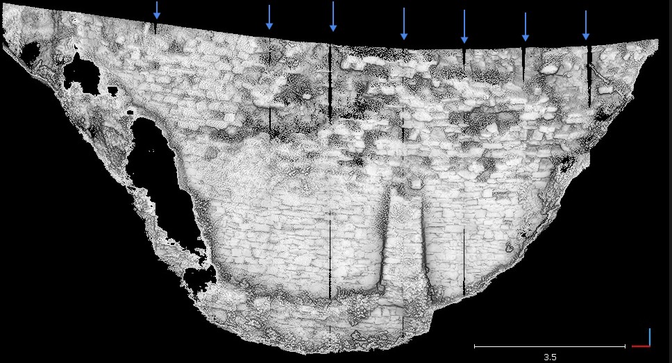

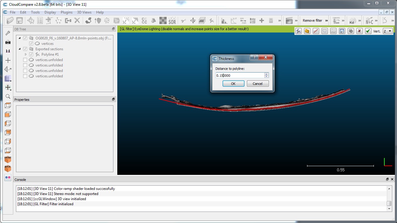

I got a gaps on resulting point clouds. Tryed to make unroll many times. Tryed to place 120 vertex on polyline to get smoother polyline. Tryed different Thickness on Distance to polyline dialog. Always I getting this gaps.
Is there a way to make unfold point cloud without a gaps on pertex position?
And daniel has same problem too on his result
I'll have to investigate a little bit more about this to give you a proper answer but I remember it happens when the wall is not perfectly vertical. At least on the tower example this was the explanation.
Don't hesitate to send me your data and I'll look into it (cloudcompare [at] danielgm.net).

daniel wrote:I'll have to investigate a little bit more about this to give you a proper answer but I remember it happens when the wall is not perfectly vertical. At least on the tower example this was the explanation.
I sent my point cloud to your mail.
Yes, my object is not so vertical...
Okay I'll look at it in a few days (I'm currently on the move).
