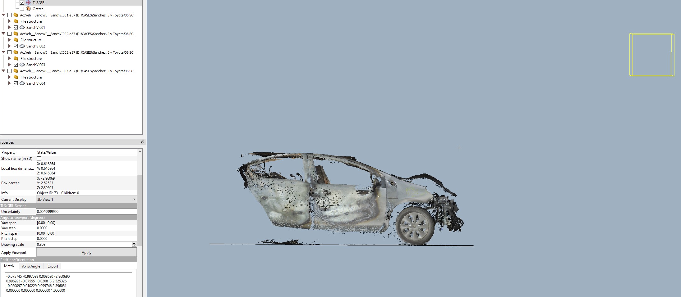

Hopefully these screenshots help. You can see the scanner head in FARO Scene and CC are in slightly different places. I didn't insert the screenshot twice. The insert attachment is just acting funky.

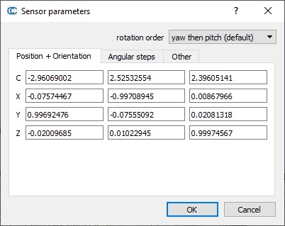

I didn't know about that feature. Here are the sensor parameters for that same scan:
