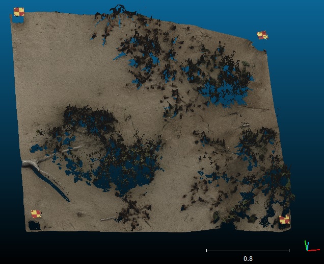

Ok, the issue seems to come from the way you created the mesh.

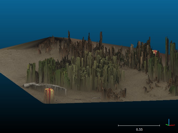

It seems that you have used the the 2D1/2 Delaunay triangulation method. The result of this algorithm can look quite good from above, but in fact it creates some wrong faces on truly 3D clouds or even on 2D1/2 clouds when there's big variations of height:
2D1/2 Delaunay triangulation issue
Those wrong triangles can really jeopardize the C2M distance. To properly mesh this kind of cloud you have to set a maximum edge length (something like 0.05 on your example) so as to avoid creating those big triangles on the sides:

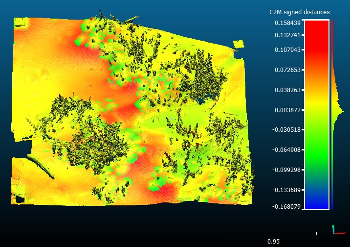

With this mesh, the C2M distances computation gave me the following result:
Cloud to mesh distance
Properly meshing the vegetation is almost impossible here so you still get strange 'inverted' patch near the vegetation or holes.
Maybe a good idea would be to remove the vegetation first (with qCanupo for instance ;). And of course M3C2 is clearly superior.
