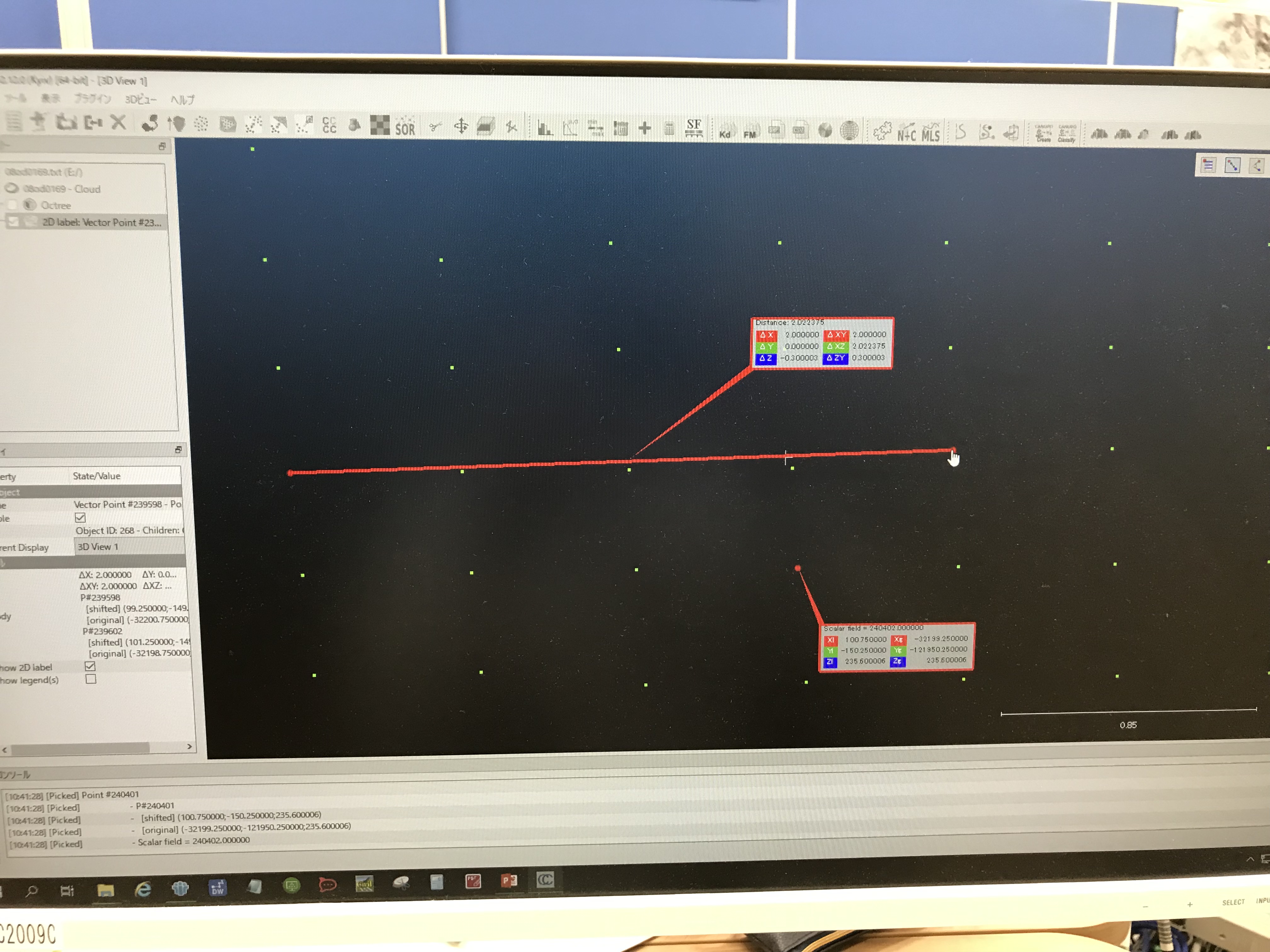

Hello.
I am a civil engineer working for a local government in Japan.
I am helped daily by the great features of Cloudcompare.
I would like to ask a question about the distance measurement function of the latest version (v2.12.0) of CloudCompare.
When measuring the distance of an enlarged point, it is not possible to measure the distance continuously from the latest version.
As you can see in the picture, it is not possible to select a previously measured point.
This was possible in past versions.
We apologize for the inconvenience, but we would appreciate it if you could check.
Re: About distance measurement function
That's interesting. Let me check and I'll get back to you!
Ok I fixed the bug. I'll try to release the 2.12.1 version soon.

Mr. Daniel.
Thank you for fixing the bug.
We look forward to the release of the latest version.
The version 2.12.1 version has just been released. You can find it online.
