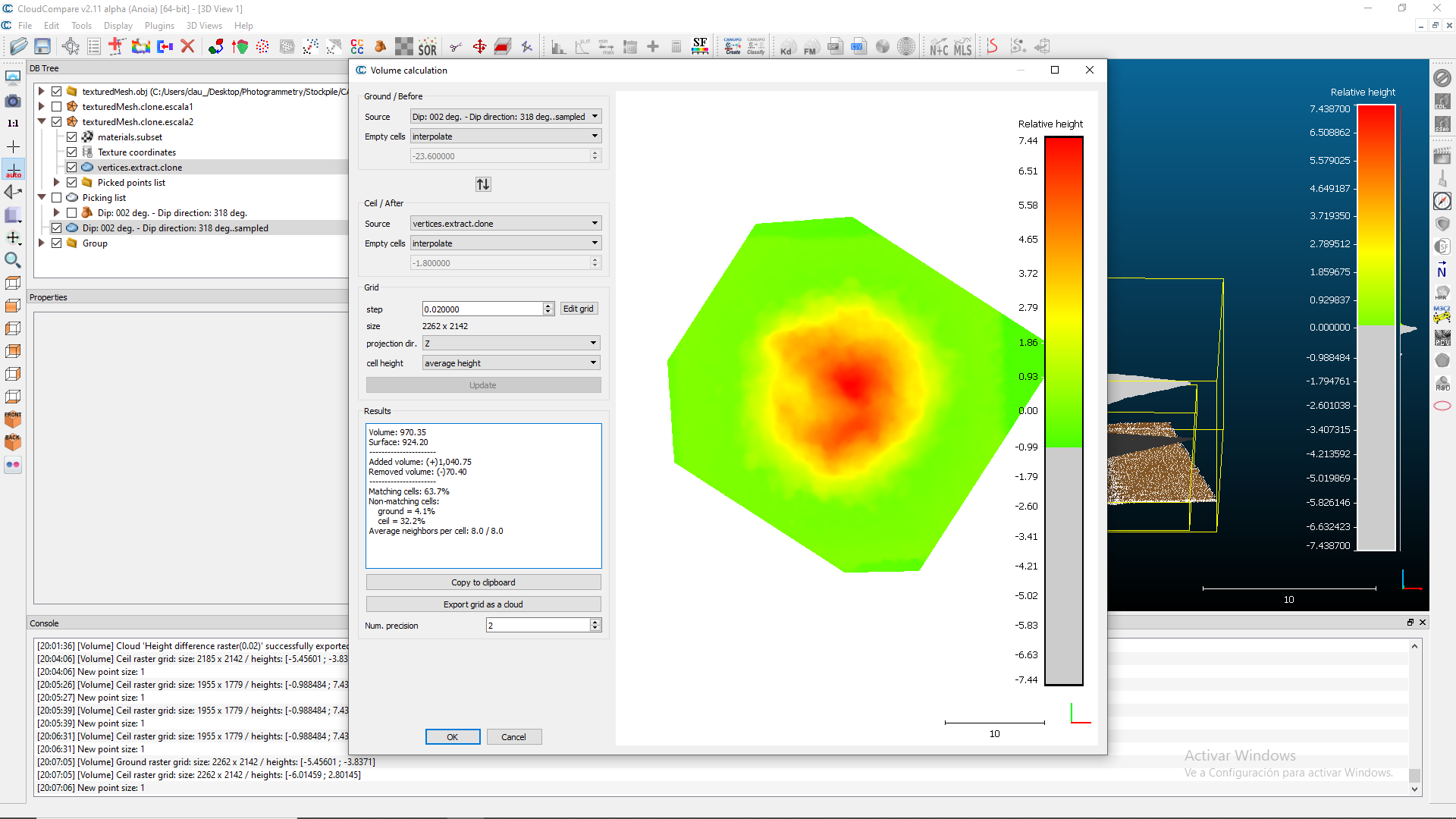

Ok so i'd just tried the "scale correctly" thing right away with another similar model i had and i reach this.
resultado positivo-stockpile1.png (255 KiB) Viewed 6754 times
The calculated value was 970 cm3 and the real value was 951 cm3. That means a deviation of roughly 2%. WICH IS AWESOME !!!!
Now i'm thinking about what you said Daniel of placing a box and that could work for me in two ways.
1) the box's sides could give me an scale dimension
2) I could calculate first the volume of the reference box and check with that if the result is correct.
Re: Stockpile Volume
Yes, good idea! Normally if the clouds are dense (and since you are working with meshes, you can virtually get infinite density) the calculation should be pretty accurate (well as accurate as the 3D model is).
