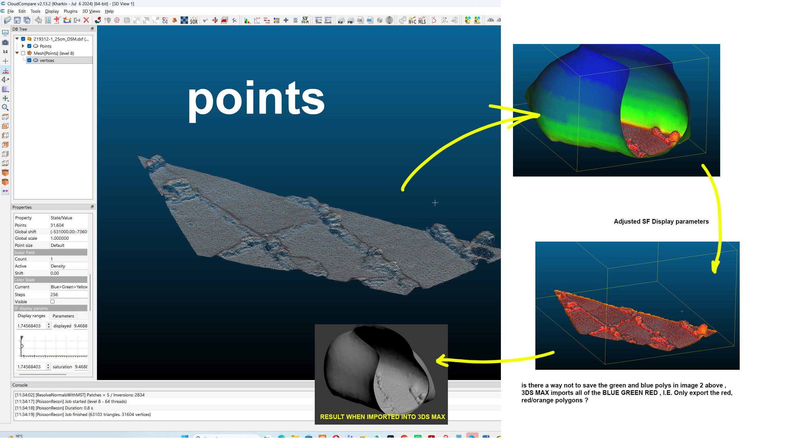

Hi all,
I'm completely new to CloudCompare and just starting to use it for converting dxf point data into dxf mesh model, - working well but i have one question, when i run the PoissonRecon I get the scalar field which add more polygons to the scene, is there any way to exclude or delete the additional polygons - i hope the attached image makes it clearer to what i'm trying to achieve.
thanks
T

Yes, if you refer to the text in the dialog about the 'density' scalar field, or to the documentation: https://www.cloudcompare.org/doc/wiki/i ... n_(plugin)
(see the section about 'Using the output density'.
