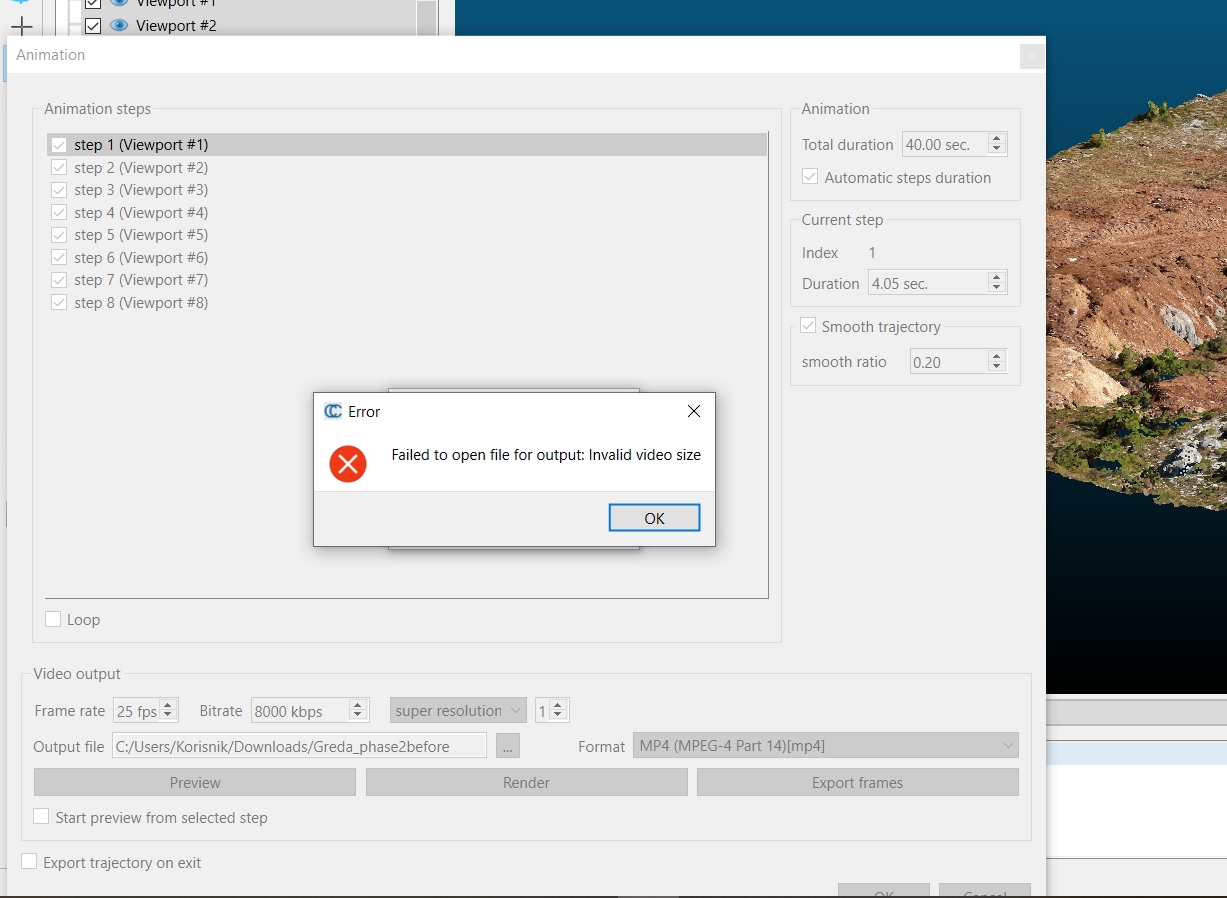

hi, I would also like to bump this, we get same message.
video cloud compare.jpg (209.53 KiB) Viewed 22383 times
Preview is working ok, Export frames is working also, but when you click Render, that message apperas
we tried with MOV and other video formats, same message.
frames can be exported and processed in third party software, but it would be much easier if Render work

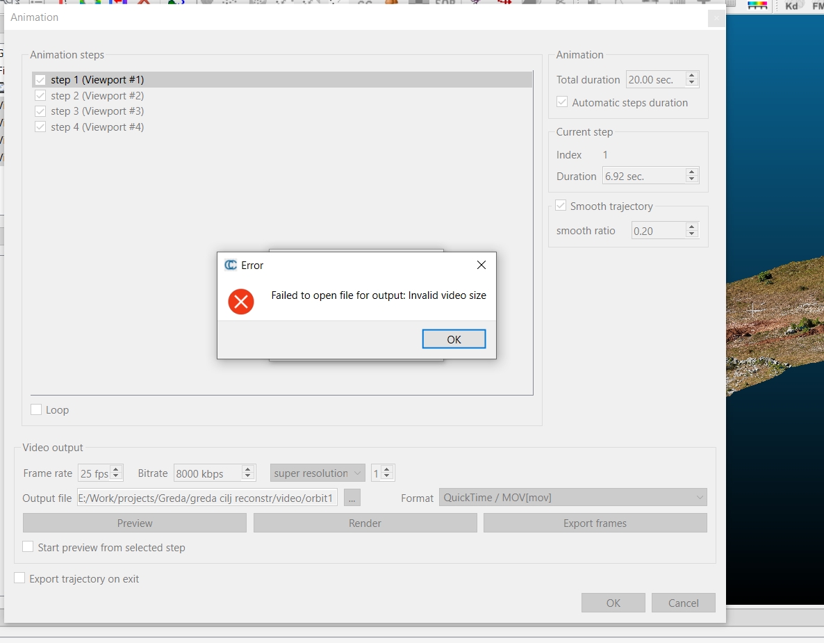

you mean like not full screen? i did it just now, same message.
i did it provisionally, maybe there is some methodology?
i tried other options than super resolution, only one available is zoom, and it is the same with it
like i said, frames are exported in selected folder, preview works, just Render is the issue
