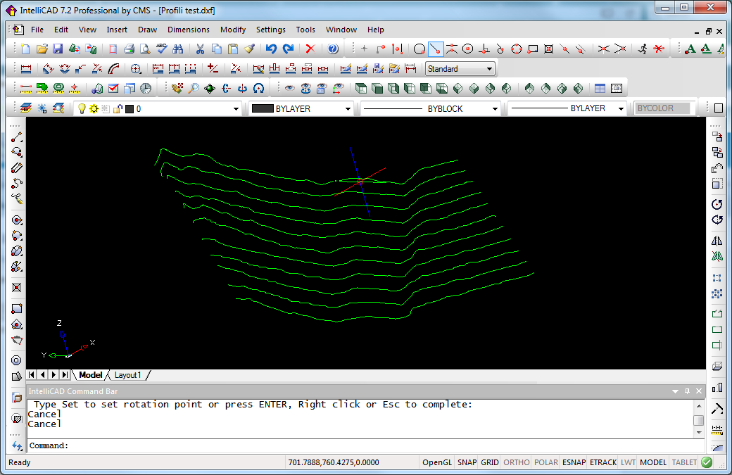

Here's what I get in IntelliCAD, which is very similar to AutoCAD. I rotated the view so you can see the profiles. You should get the same thing in AutoCAD. I saved the file as a DWG in AutoCAD 2010 format attached to this message.
Profili test.png (104.74 KiB) Viewed 16997 times

Great! This works! Thank you very much cdordoni for your interest and for the conversion.
Today I could discuss and check with a proficient CAD user as well, and he told me that actually the DXF file generated by CC is correct in 3D (for example, I could import it in the program I used to generate the source point cloud and they match); the only issue is about enabling the proper views in CAD, isometric view in this case.
Also, the file opens without units, so either they have to be properly set while opening the file (metres), or setting the scale in the file once opened after some known value (10 metres spacing in this case), and they match the original point cloud.
