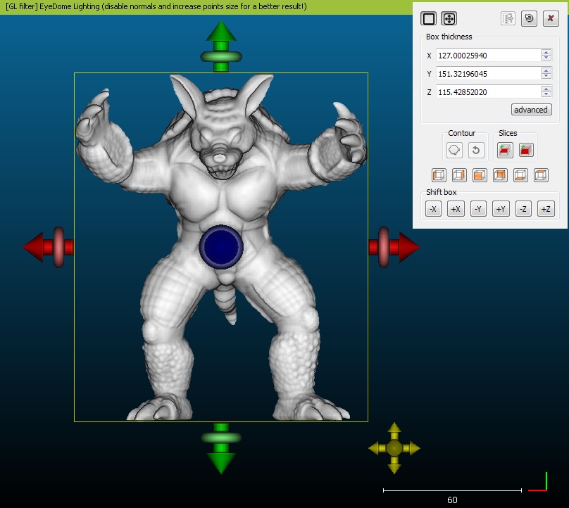

A dedicated dialog will appear in the top-right part of the 3D view.
Note: the initial clipping box is the cloud bounding-box.
Editing the clipping box
The clipping box can be edited in various ways.
Interactively
You can drag the 'interactors' (big red, green and blue arrows and tori) so as to move the clipping box boundaries directly in the 3D view. The arrow tips are used to push and pull the clipping box faces, while the tori can be used to rotate the box around the arrow axes.
You can also translate the whole box with the lower-left (yellow) interactor.
Note: you can show or hide the interactors and/or the box with the two icons on the top left part of the dialog.

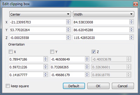

Eventually, if you need more control, you can click on the 'advanced' button. A 'standard' 3D box edition dialog will appear. You can setup the box position in space in various ways (and even force the box to be cubical for instance).
Since version 2.6.3 you can also setup the box axes this way.

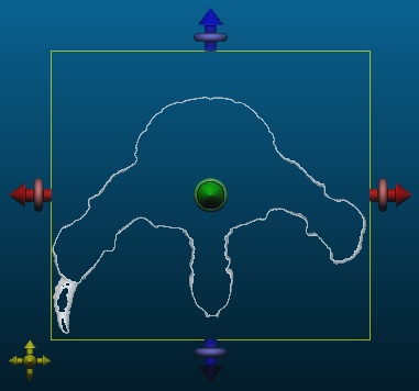

At any time the 3D view camera can be changed so as to face one of the clipping box faces. Use the standard 'predefined views' buttons in the lower part.
It can be useful to hide the interactors as well in order to properly see the current cloud section:

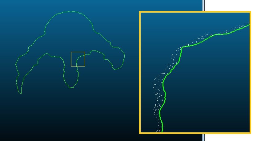

Extract a single contour
Instead of the subset of points corresponding to the current slice, it is also possible to extract the (closed) contour of the points.
To do this click on the 'Extract contour'
button (in the left 'Contour' frame).
A dialog to setup the contour extraction process will appear:
The user must set:
- the 'flat' dimension (it should be automatically setup based on the current section dimensions).
- the maximum edge length: the contour is extracted thanks to a 'concave hull' algorithm. The only parameter for this tool is the 'maximum size' of a single edge (if possible). The algorithm starts from the convex hull of the slice points. As long as an edge is longer than the specified 'max length', the algorithm will try to split it by using another point in the vicinity. This way the contour will fit the cloud more tightly. So the smaller the parameter is, the tighter the contour will be. Note that this 'maximum length' can't be guaranteed as only the input points are used.
Additional options are:
- project slice(s) points on their best fit plane: the contour extraction is done in 2D. Instead of using the slice flat dimension as projection plane, CloudCompare can project the points on their best fit plane (it can be sometimes better for very thick slices).
- split contour(s) on longer edges: CloudCompare can split the contour every time an edge is longer than the 'maximum edge length' parameter. In this case multiple non-closed polylines can be generated instead of a single closed contour.
- visual debug mode: for debug use (can be used to understand why the algorithm doesn't output what one would expect).

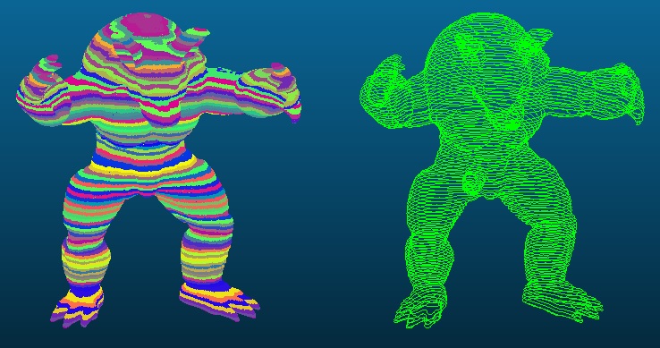

Extract several slices or contours
To extract several slices or contours at once, click on the 'Extract multiple slices'
icon (in the right 'Slices' frame).
CloudCompare will open a dialog:
Most of the parameters are the same as for the 'Single section extraction' dialog (see above).
The user must however explicitly specify if he wishes to generate contours (check the 'Extract contour(s)' checkbox to enable the associated frame). Otherwise only slices will be generated.
Other parameters are:
- Repeat dimension: the extraction process can be repeated in one or multiple dimensions (by default only the 'flat' dimension will be checked)
- Gap: a gap can be added between each slice
- random colors per slice: if checked, a random color will be assigned to each slice (warning: any existing colors will be overwritten!)
